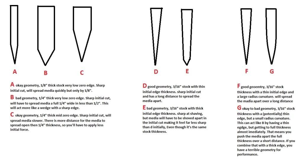

Never sharpened a knife before, read the faq on the HI site and bought the stuff, DTC diafold, strop, and green compound for the strop. I have an ASTK that arrived with a few rolled spots and if I'm going to clean it up I might as well put a good angle on it and sharpen it up.
Thin edge thats dull = more force being applied to the thin edge because it's not able to cut through the media.
Thick edge thats sharp = more force being applied to the metal behind the edge because the edge itself cuts through, the thickness of the metal behind it stops the blade and absorbs more of the force.
A dull knife is a dangerous one. By making your edge dull for use your risking damage to a thin edge, or damage to the blade itself with a dull thick edge because it will no longer be a chopping knife: It will be a hammer.

To be specific with the question asked,
Every knife you own should be as thin as it can be given the capabilities of the steel (as heat treated) and the task it's going to be employed in. If the steel is capable of taking super thin .010" thick 8 degree per side edge and maintain itself, then thats going to get you the best possible performance.
If your steel is capable of maintaining at .020" thick at the edge with an 15 degree per side edge angle while chopping wood - you'll get amazing performance out of it.
In the case of HI knives, I set mine at .030-.040" thick directly behind the cutting edge with a 24 degree per side main edge bevel, and an 18 or 21 degree relief bevel to get the thickness down to .030-.040". I've found most of the edges to be stable at that thickness. Any thicker and you start to lose performance, any thinner and you start to run into possible chips and deformation. If you go thinner, you have to be more crisp with your technique, trying to keep your angle of attack clean with no deflections, trying to avoid knots when possible, watching for inclusions like small branches wherever possible.
(degree's are all 'per side')
and a general description (my opinions) of overall geometries. Just a rough overview of what edges look like along the spectrum from paper thin kitchen knife to ground down axe/wedge.
