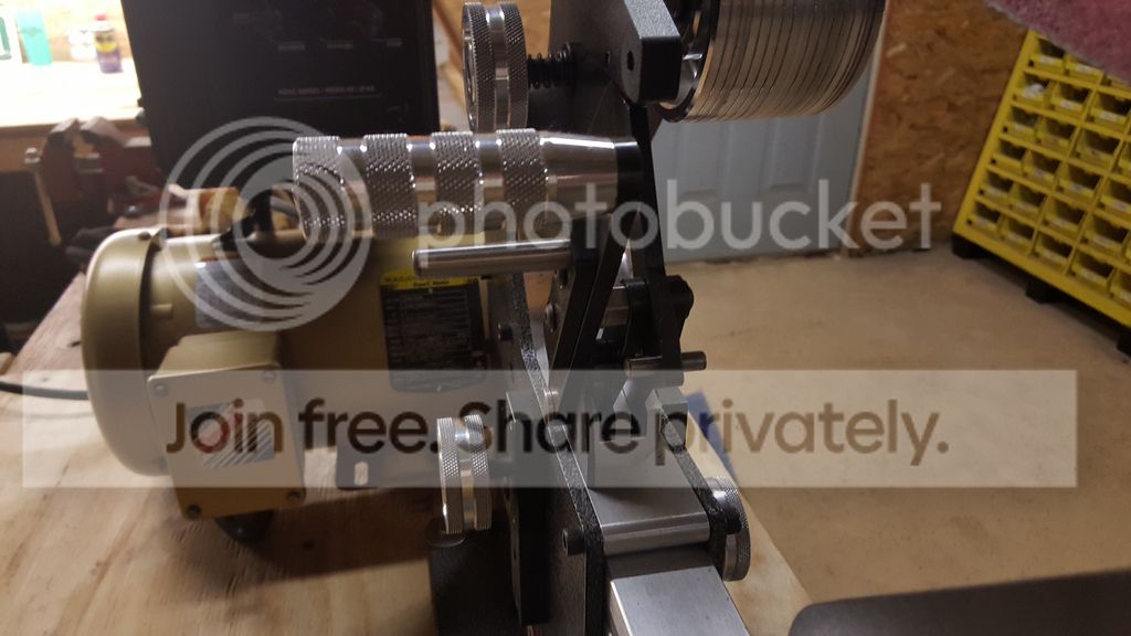

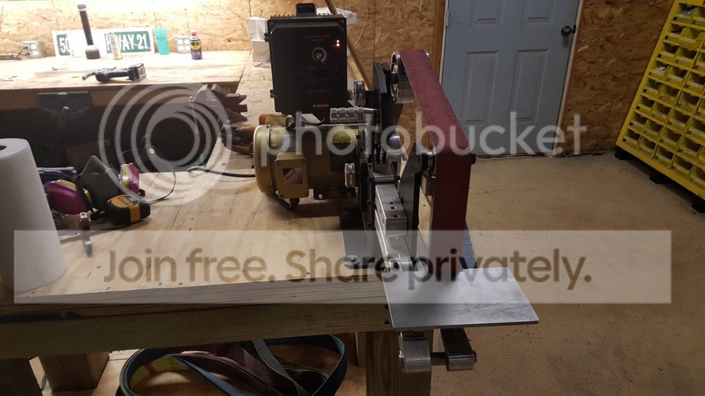

Hey Guys,
I've gone through a couple grinders starting with a KMG and decided to give the Northridge a try. One of my biggest issue is the tracking and vibration with the KMG, I've tried everything to reduce it even converting it to direct drive.
I went to George's shop and brought some fixed blades to grind and was so blown away I immediately bought his full grinder package.
Here are the advantages:
- Comes with a flip base that is incredibly and fast to flip. It is so easy to flip and has a shock. I had to build my flip table to do that on my kmg to go horizontal.
- The extra tooling arm slot just isolates the vibration so well. I got the rat arm and its amazing, it can go at any angle and double locks so it doesn't slip or turn unless you want it. You can put a coin on its side and with grinder full speed the coin doesn't move.
- Tracking is just unreal, I free hand hollow so I notice the little gouges from vibration in higher grits, but this grinder has eliminated this.
- Accessories, man these guys have so many accessories.....
- Quality, hands down the best highest quality grinder I've ever used or seen.
- Customer service, George, Chuck and Bill were so accommodating and let me grind a bunch of things to test out a machine. They bent over backwards to get me spacers I needed for my wheel and always answered my questions. Not like some providers...
I sold my other grinder and in the process of selling my kmg to get another Northridge. I can't recommend this enough man, its like going from a camaro to a corvette z06.

Good review and looks like a good grinder. Having a grinder to go horizontal is really handy for sure.
Ken H>

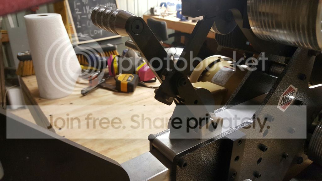

What is the purpose of that little center wheel? Stop belt flutter?
You're right, now that I look on a computer screen I see it is knurled. Didn't expect to see one of those on the belt side of the grinder.
In my opinion, that's where it SHOULD be. Release tension with left hand, pull platen or wheel forward against belt with right hand, reach over with right hand and tighten tool arm in place, release tensioning arm with left hand. One of these first modifications I did to my crummy KMG.
Yeah, I can see the utility. I was going to make a ratchet for mine like the TW-90 and just never got around to it. Probably never will, it doesn't bother me much.

That is lock your looking at, you can lock it from both sides, whichever you prefer.
I think this is better than the tw-90 for a lot less. And it does have a rachet system I just didn't get it.
There is no comparison of the arm on this table vs the Esteem. The northridge has double locks, easy to change around and the most stable work table I've ever seen or use. I'm about to list my kmg and get another northridge.

Yes 10" wheel will fit. I have a 12" and will be putting a 14" soon.
The drive wheel is not crowned and has zero wobble compared to my other grinders.
