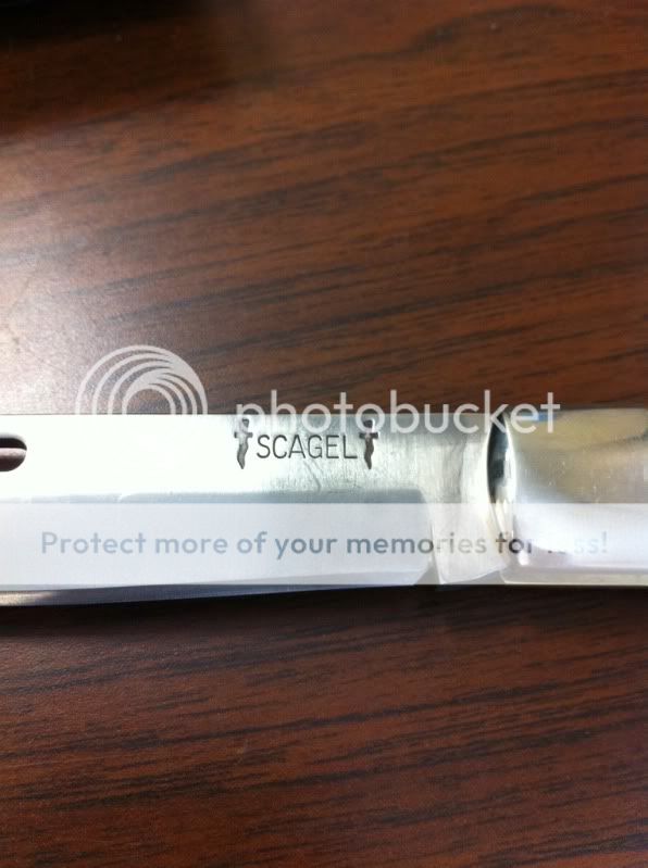

I've been using this beauty daily since I got it a working edge, and the patina it's getting is strange...
That spot on the blade just past the bolsters is the only spot it's taking any patina. I used it last night to cut my steak, I've used it to cut strawberries and bananas for my breakfast everyday. Is there something that could be keeping it from developing a patina?
My experience with 1095 is that is takes a great multi color patina from all the foods I've been cutting. And yet just that one spot with the Northwoods..

Great review! I have a Northwoods Scagel Fruitport that has also started to develop and odd patina but it is only on the 1st 1/3 of the knife. I've cut with the back section but it remains clean of patina. The 1095 used does seem to get the multi-coloring on mine too.

Not sure on the patina problem. All the 1095 I have used develops one quite quickly. Perhaps it has a dry oil coating ?

Dry lube or something similar is what I was thinking too... Washed it with sail and water.. Still just that 1/2" or so is the only spot taking patina, whereas my Becker necker took a patina with one cut of an orange..

The patina thing puzzles me. I take it you've cleaned the blade with a bit of alcohol to get rid of oil/finger fat? Should be blackening up by now especially if you fruit&veg prep with it.If I didn't know better, it looks like D2 to me...:confused:

Willgoy: I doubt it's D2 as it is taking a patina in that small portion. I was wondering if the coated the steel with something or maybe a special treatment that is preventing the patina. I haven't wiped it with alcohol, just soap and water. I'll try that when I get home..

My Queen D2 knives take a while to develop spots or colour but they do from meat in particular.
I'll bet it's D2... that patina formation is exactly how my Queen Copperhead started. Took a long while to get any color, and then finally started, but just in that very same spot near the pivot.
It might of taken a while to sharpen and to get the edge you were looking for, but the blade steel is 1095 on this one....

No idea on the patina...1095 will stain just spitting on it....
That's been my experience with it too.. Which is why I'm so baffled by this.. I emailed KSF about this and never heard back

In terms of developing patina, look to see how much oil/grease is on the blade. With two of my 1095 slimline trappers that I use a lot, there is a very fine layer of oil/grease on the blades. It comes from the factory, oiling the joints, your fingers, cutting sausages, etc. Even if I wipe it with a single swipe with a cloth it remains. It acts as a protective coat. IMHO - patina should be earned with years and not instantly applied. :rolleyes:
- David
Clean the blade with brasso or a similar metal polish.
Then it will take a patina faster once it is clean from any grease or oil
