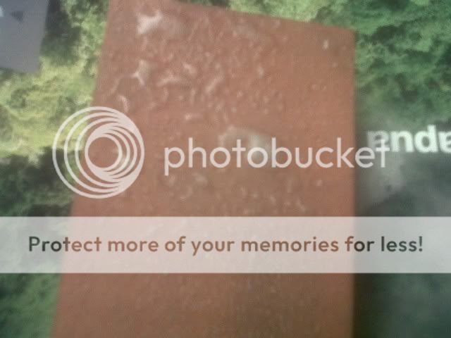

I started using windex on my India stone, as others have recommended - but the stone kept clogging up. So I soaked it in warm water, and scrubbed it with a brillo pad. After the 3rd or 4th soaking, I noticed grease was rising to the top of the stone. I scraped it off with a business card. It remains a solid at room temperature. Anybody ever seen this?

I can't make heads or tails of the photo but I agree w/ Harpoon. It doesn't take long about a 3-4 min. boil. Observe the water before pouring it out. DM

The business card is blue, the white stuff on the edge is the grease. I was aware that some people have boiled their stones. It just seems odd that Norton would impregnate the stone with grease. Seems like the worst possible thing to use.

Well, I didn't use much windex - just 2-3 sprays per side. The brillo pad is just a generic type plastic scrubber - no additives. I don't know what the consistency of the "oil" was when it left the factory (Mexico), but now it is saturated with grease that has the consistency of Crisco. I haven't boiled it yet, but I'm going to. I took a pic of what happens when I put the stone under the hot-water faucet. The stone is fully dry in the pic, all of the droplets are grease. The water melts the grease, and it is forced through the top/bottom/sides. I thought I could get away without having to boil it. I thought using windex or water + cleaning would eventually force most of the "oil" out. Given the consistency of the oil/grease, that probably would have been a losing battle. So, thanks for the input guys. I agree that boiling these stones is necessary. Seems a shame, but other than that it seems like a very good stone.
