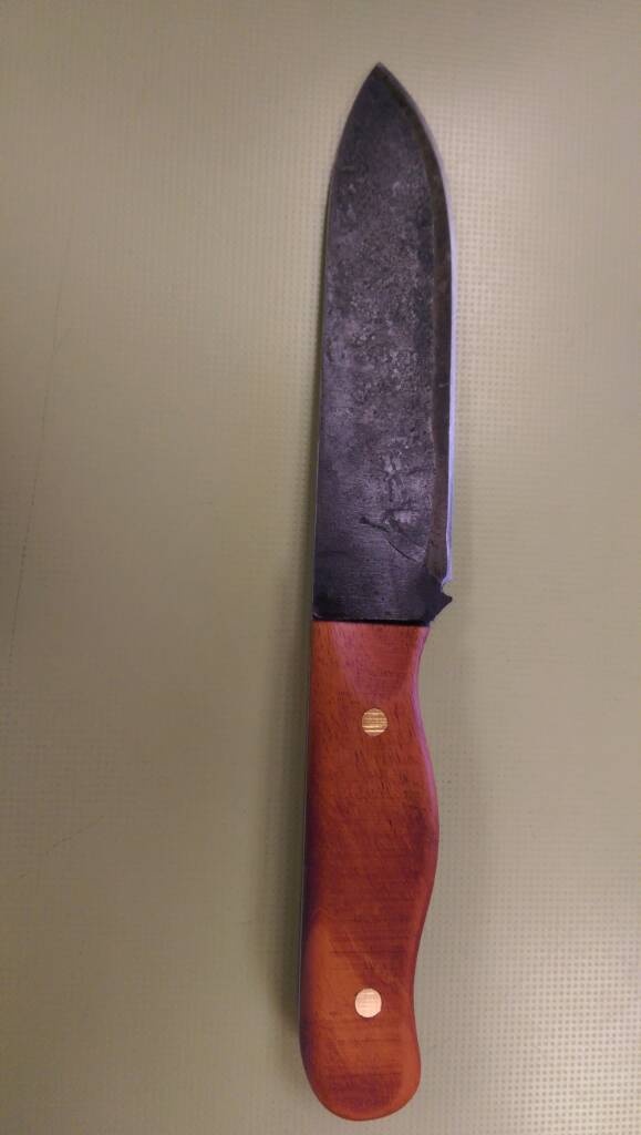

I'm a self tough learning as I go aspiring bladesmith .
Everything in this thread is hand made including some of the machine's
Not bad for my second attempt at "Hamon"
Please, I'm familiar with forums and appreciate all comments
Blade material = 1/8" thick circular saw blade cut out and shaped on my sander
The handle that you don't see is a deer antler that a friend found in the brush
The "clay" used was Rutlands furnace mortar .
Links below are from the top and butt end of the knife in the vice.
Most recent to date
A custom Skinner with my orange fabric micarta and of course it has "Hamon" cause I love the appeal and function of it
Just one more take on a lawnmower machete.
Blade thickness is 0.132
Blade width is 2" 1/4
Blade length is 12" 3/4
Overall length is 19" 5/8
Handle is my homemade denim micarta held together with epoxy and 1/4" brass pins
