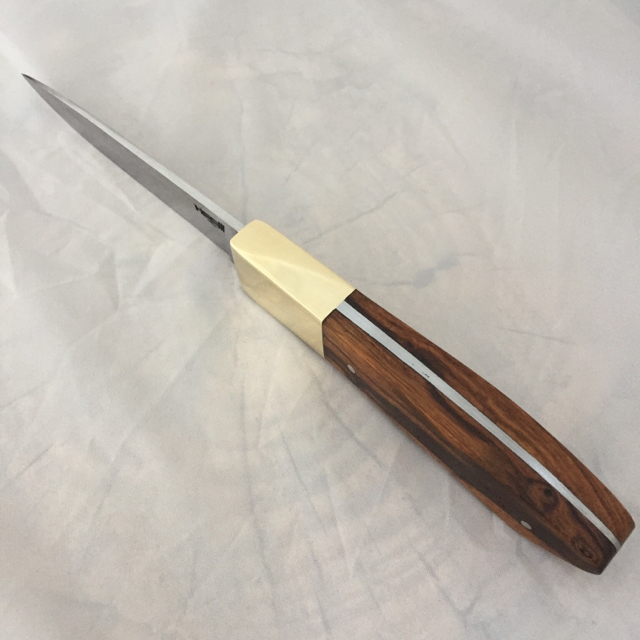

I am doing a build with a brass guard. It will be a slotted guard and I am planning on notching the front of the tang to accept it. I am using 1095 and would like a hamon so I'm thinking brine quench. To lesson the chance of breakage, I'm thinking of notching it after heat treat. Will a portaband be able to cut a hardened piece of 1095? I'm thinking the cuts will be no more than 1/4" deep. Answers to this question and general advice appreciated. Thanks.

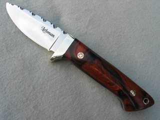

Kevin, Why not trying to finishing your blade in the ricasso area to a smooth surface and fit your slotted guard very tightly and then drill two holes through both the guard and the blade. After heat treat finish the ricasso area lightly to the finish you want and pin the guard in place. It won't go anywhere when the knife is used. I have done this many times with no problems. Larry

I think notching is a solid way and can be used in Lieu of pinning
I also like it because it gives you a top saddle look
