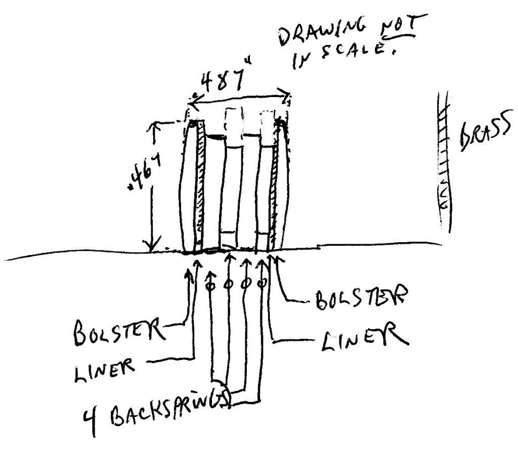

I have a couple of those 4 spring 64052s, in a small group of modern Case knives I haven't really looked at in 3-4 years. They are indeed wide knives relative to their height.
the average of two widths on one knife is .487" (measured mark to pile) , vs. .467" (backspring to top). Tough to scan the end, I did a drawing. (Not an artist by any standard:p, I hope you can interpret my scribbles.)
I've been told by knife producers that one spring per blade is much easier to assemble. I suspect that all four springs are identical, making the parts easier to manage. The whole idea is to cut costs, as labor is much more expensive than parts, IMO.
