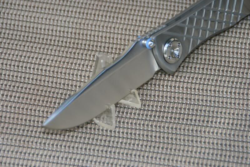

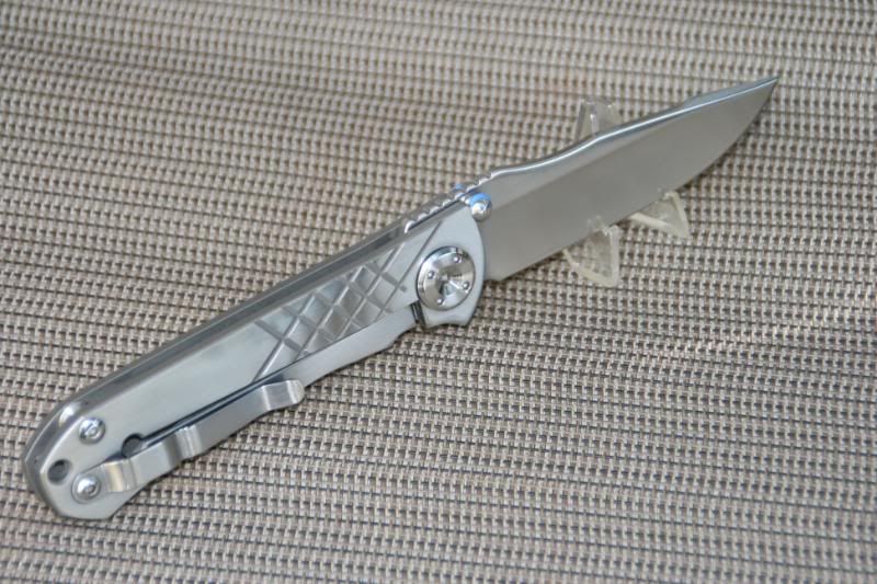

Here's a Zaan i pimped for a good friend....i spent mega hours makin this knife super sweet for him but unfortunately his handicap keeps him from using it and now were gonna try a flipper/auto.
I thought i would post some pics.

Looks like there is a dark stripe on the handle as well as on the blade !! Are these just reflections? If so I'm equally impressed with the mirror finish u must have put on it !!!!!

Looks like alot of time went into that one! I don't care for how the crispness of the ginds was sacrificed. They are too soft, IMO. Hopefully you didn't heat the blade up while polishing and ruin the temper.
Regardless, it's too bad your friend can't enjoy it. But I am sure there are plenty of people out there who would love to have a worked over Ummi like that.

The lines were not sacrificed at all !! and the blade NEVER was past warm !!
Polishing S30V thats been hardened is not like polishing aluminum where you can move the metal with compounds....95% of the work must be done by hand where the hollow part of the grind is done with a sanding block the same radius as the wheel that ground the blade and the flats are done on a precision ground piece of stock...thats how the grind lines stay "crisp".
This blade is a satin polish that required very little time on the buffer....my edc is high polished and the temper on it also was not compromised .
I really like it. It looks really cool.:thumbup: Where do you find the blue o-rings in the correct size? Some would look great on my Zaan.

That's delicious looking! Nice work, indeed.
