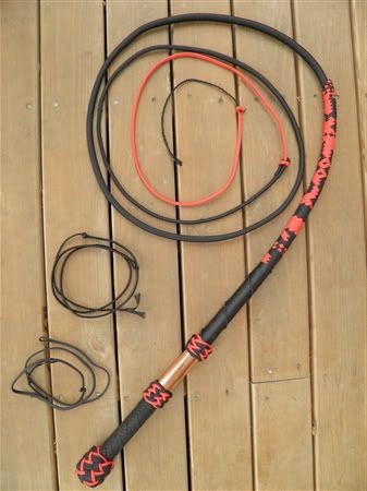

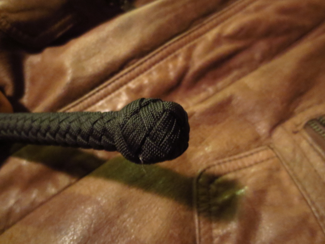

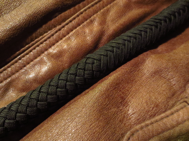

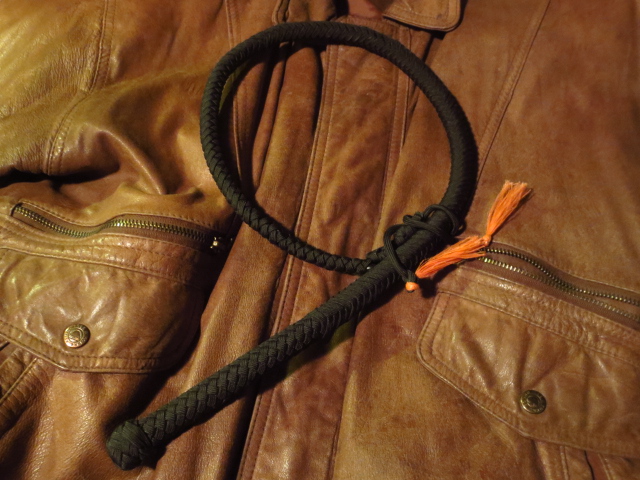

Whenever I have the time and materials, I like to sit around and plait a whip. This is my recent finished project, a 36 inch mini bull whip. It is a 12 plait with a diamond plaited handle (first time trying the diamond plait, it came out quite well) and pineapple turks head knot at the rear. Bull whips are suppose to have a knot (like the rear one) covering the transition point where the handle and the whip meet. I did not put one on this whip (for simple lack of getting around to it), but I think it looks quite nice without it.
