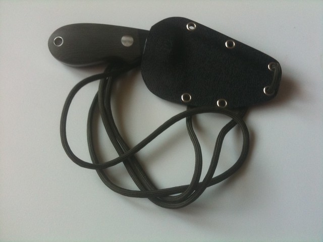

Here's a little neck knife I finished a little while back.
6" OAL
3.25" handle (Green Canvas Micarta with Black Linen Micarta bolsters; 1/4" scales)
2.75" blade (2.25" cutting lenth, .5" ricasso)
1095 high carbon steel, HT'd by myself
Stainless hardware (5/16" corby and 1/4" lanyard tube)
Concealex sheath with OD 550 paracord lanyard
Jimping for thumb

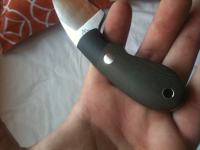

I call this one the "O.G" (Ogee) neck knife because I designed the handle around the "ogee curve" that's commonly seen in furniture/woodworking and architecture.
Though small, the handle is very comfortable and fills the hand quite nicely.
