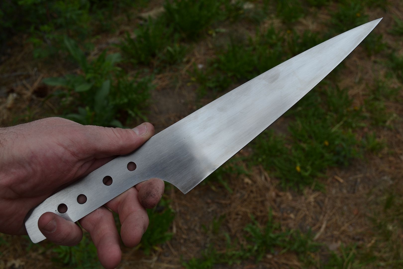

O1 Chef's Knife in Progress
Daniel Fairly Knives
Full Time Knifemaker
Moderator
Jan 9, 2011
16,486
O1 Tool Steel
.062" (1/16") thick at the ricasso
double plungeless flat grind
62-63 RC Hardness!
I'm still not finished with the grinding...I've already gone through a pile of belts on this one, it is amazing how wear resistant O1 is at 62-63 RC! :eek:
More grinding and testing to follow...

I'll be back off to grinding it after a break. Testing was good and I'm going to grind it a bit thinner.
Will it have any belly at all when you are done?

Not much! It does rock nicely though with no flat spots.
Everyone keeps asking me for less belly so I went for it. I have only tested it a bit but really like it so far.
This one is Japanese influenced as far as the blade shape goes... it will rock or slice.
I'll test it a bunch as it is different for me both in belly and hardness.

This one is Japanese influenced all the way, I suppose it may be a Gyuto.
Funny enough I usually do single bevels but had to mix it up this week! A Deba would be fun.

Thanks! I have been pushing my RC higher lately with everything... pretty much everything is 60 RC plus.
I haven't done any at this high of a hardness (62-63) so I'm going to do a lot of testing. I'll say at this hardness O1 is just nuts, I have already used 3 - 80 grit belts on it after removing the decarb with a used one. 3 - 120 belts and 2 - 320... :eek: I'm expecting superior edge retention.
I'll be switching to 52100 and CPM154 later, my experience with 52100 has been excellent.
I know what you are saying! I only use 01 and I have tried to leave the RC above 60 a couple times and the steel doesn't seem to want to grind off! I got tired of it now I just shoot for 59 RC. Seems any higher and it takes so long and eats so many belts its not worth it:)

I hear you! Hopefully the end result is worth it but I am having fun pushing the limits either way. I really enjoy tying to squeeze the most performance out of the steel.
I left the RC high and my ht regimen was changed a hair, I soaked at a slightly lower temp for more toughness.
