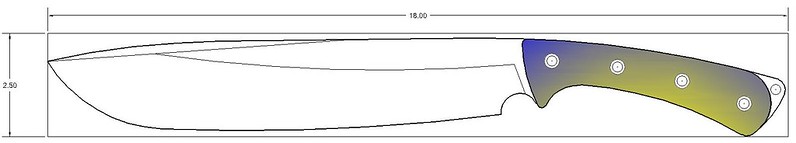

Preliminary sketch:
O1 Model 1 Sketch by mysdnc, on Flickr

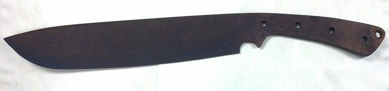

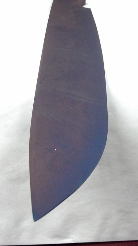

After first draw (turned it a cool purple):
WIP O1 by mysdnc, on Flickr
Go ahead and do another temper cycle at 500F for 2 hours right away.
Then sharpen the edge and do some testing to see how it holds up on the stuff you want to cut. If it's a little chippy, either draw the blade again at 25 degrees higher, or thicken the edge (just dull it back and resharpen it).
57.5 is a very good balance of hardness and toughness, and O1 is a good tough steel anyway. I suspect if your edge geometry is right (mostly meaning not razor thin), you won't have to mess with the hardness much.

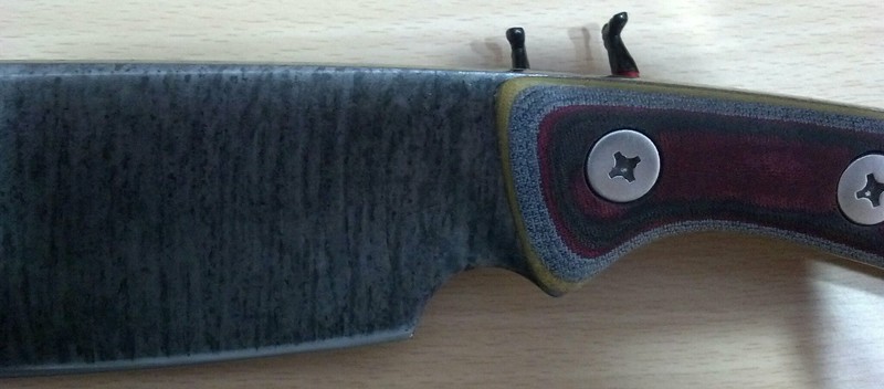

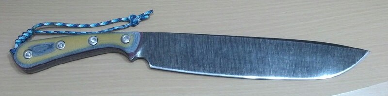

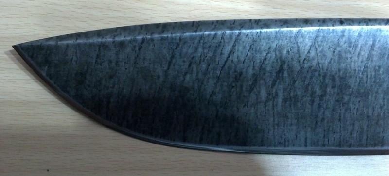

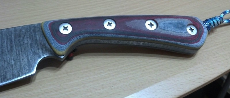

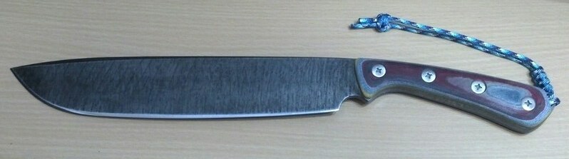

OK, I wrapped this one up over the weekend. What do you think? I ended up forcing a patina with yellow mustard and ferric chloride.
I've learned a whole lot of things from this process, and I'll apply that to the next one:
1. Thin the edge! I was nervous about having an edge that it too thin and might distort from the heat treat & quench. Wow, was I wrong. I think roughing in around 0.015'' to 0.020'' would have been the way to go.
2. Do as much finish work as possible before heat treat. Soft metal is a lot easier to grind away than hard. Also, the finish should be as smooth as possible. Any scratches before heat treat will be there after, and a LOT harder to grind out!
3. Plan, plan, plan. I thought I went into this with a good plan, but there could have been more. Simple things like handle fasteners and the right adhesive should be worked out (and in hand)before any metal is cut.
4. The steel is tougher than I think it is. This could have easily been made out of thinner stock without any performance loss. However, I still think it looks good with the thick (5/16'') stock.
5. Make a wood/cardboard mockup. I would have modified the handle shape slightly (made it about 1/4'' taller) if I would have made a mockup to test fitment.
Thanks for any and all input, good or bad! I'll start making a sheath out of veggie tanned leather this week, and try it out on a camping trip next week.
Sam

For hillbilly micarta, those colors worked out great- nice patina, as well. This chopper will only look better as it weathers. Good job!
Thanks guys!
I went out & chopped up some limbs & random things this evening. It was OK, but I think if the stock was a little thinner it would chop better. OTOH, it splits wood like a champ!
On to the next one!
Very nicely done. I like it a lot.
