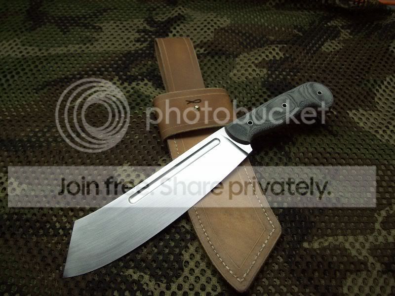

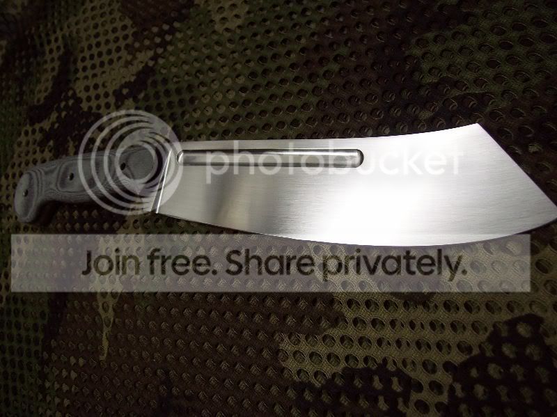

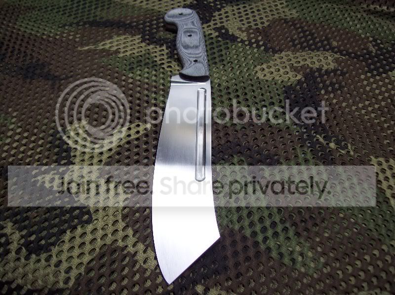

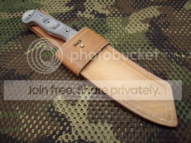

I finished this one up in mid February. It was made for (and designed by) BladeForums very own Marcus Lin aka "Flatgrinder" here on the forums. 5/16" O1 with black linen micarta scales (finished @ 150 grit) and red liner mounted on a tapered tang with 3 SS lanyard tubes. I finished her up with a frog style sheath :) To say that this thing packs a wallop would be an understatement !! This bad-boy is an exceptional chopper !!
Marcus is a pleasure to work with and has been coming up with some really great looking designs. If any one gets the opportunity to work with him he comes highly recommended :thumbup: :thumbup:
That is a SWEET chopper. Ive been mening to do a blade style like that for a while.
How'd you cut in the fuller? Endmill?

David, (& Garrett in response to your PM) I cut the fullers with a ball end mill and polished with SC stones

That's awesome! I've always wondered if fullers milled into a full flat-grind would come out straight. Now I know.
Were the fullers milled before the blade was ground, or after?
What are SC stones?
Yes, Marcus is correct in that the fullers were milled prior to grinding the bevels.
SC = silicon carbide ;) Sorry for the confusion. See attached pic for an example of my polishing set-up. It shows a "Diprofil" reciprocating polisher and some of the attachments that are available. The power source is a foredom flex shaft. The stone you see clamped into the business end of the diprofil is a 1/8" x 1/2" 320 grit silicon carbide stone.
