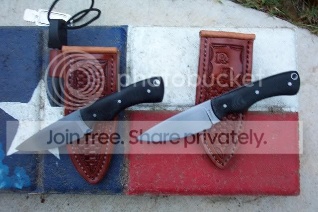

here are a couple shipping out very shortly
01 tool steel 5/32 stock
flat ground convex edge
hand rubbed finish
stainless fittings micarta handles
8 oz hand stitched lined sheathes
unsheathed
thanks for looking later Luke
What is the overall length of these? Great looking blades and sheaths. Excellent work.
Bill
Really nice design, especially the flat ground one on the right. Nice work man.

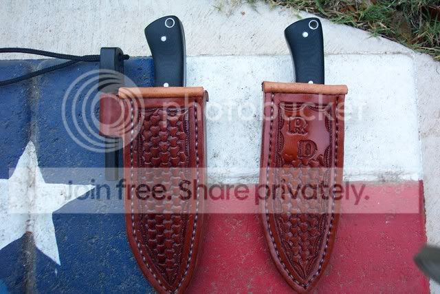

Beauties. Those sheaths are fantastic. What is it about a lined sheath that looks so good?
Sweet!
Bill
These blades are +/- 7 inches overall..little over 3inches on the cutting edge..thanks for the comments guys..Fiddleback..i copied the idea from Paul Long..he is my idol as far as sheaths go..but he always calls me Ralph..later Luke
That kind of companion design, both the blade and handle, [with emphasis on the index finger control, and rake of the handle enhancing power at the tip], are my favourite types of design bar none.
Nice looking.
For my own tastes - I'd suggest decreasing the area of the scales on the sheeths, just a tad, to make the design slightly more subtle, but then many others said they really like it as is. The firesteel loop would be nice lowered a bit so the firesteel handle doesn't interfere with the knife draw.
The blade shape looks super functional and the flat/convex is perfect. Visually, the knife handle being similar in length to the blade is very appealing to me. I really like the looks of them! What is the blade length and overall length?
Great set!
