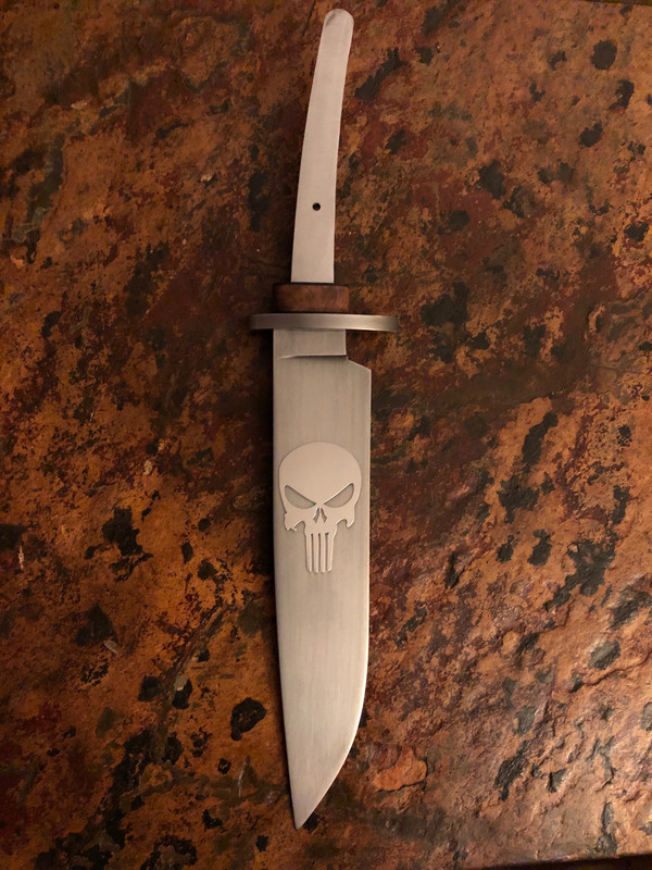

Hi,
I’m getting some “dots" after HT. This is on O1 steel.
I believe I read that this is caused by soaking it at too high of a temperature or too long at that temperature. The term for this is escaping me right now. It’s not bubbling but something similar, if I recall correctly.
I need advice on what adjustments to make.
Here are my HT steps:
1. Heat the oven to 1250. Once at temperature insert blade in the oven and soak for 15 min.
2. Ramp to 1475 and once there soak for 30 min.
3. Quench in 120F Canola oil
4. Temper twice at 425 for 2 hours.
I’m expecting a hardness of around 61 HRC.
I’m assuming the 1250F for 15 min won’t harm it. I’m doing it to get the oven to stabilize.
However the 30 minutes soak at 1475F may be excessive? What do you think?

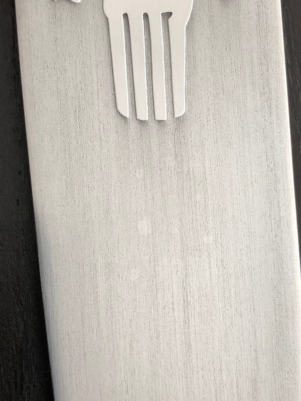

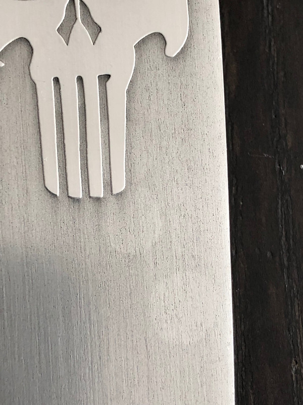

Here is what I'm talking about and I also coated the blade with ATP-641 to prevent decarb.
Thanks in advance,
Constantin
I do o1 the same way with the same temps, I hold at 1475 for 10 minutes and quench in 130 canola oil. I notice if I leave it to soak any longer I get blotchy decarb which look like circles and whatnot. Grind through it and you’ve got good steel. I temper at 400 twice and have been tested at 59 Rockwell.
So try a little less soak or if possibly less temp..
K KNelson , thanks. I’ve updated the post with some pictures. Is this what you’ve seen in your experience?
Hmm not quite.. I’ve seen more of a faint blistering look.. that’s new to me haha run a corner of a file across it and see if there is deviation in hardness?
I can’t help with the blotches, but I’d like to see the rest of the knife, looks like a cool symbol on there.
Those are possibly areas that weren’t degreased or cleaned enough. When I etch, I clean with dawn and water several times. Dip in ferric and check to make sure there’s a uniform etch then dip again.
Thanks, unfortunately I spoted those big circles before acid etching.
I wonder if 30 min soak is too long, any idea?
Now you make me wonder, maybe i didn’t properly degreased before the ATP coating and heat treat, could that have been the issue?
