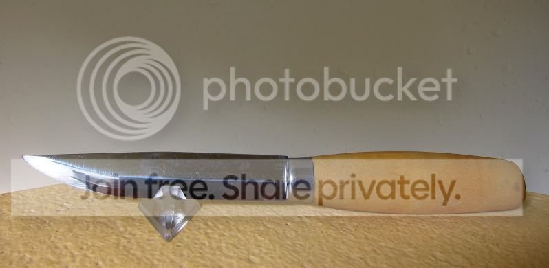

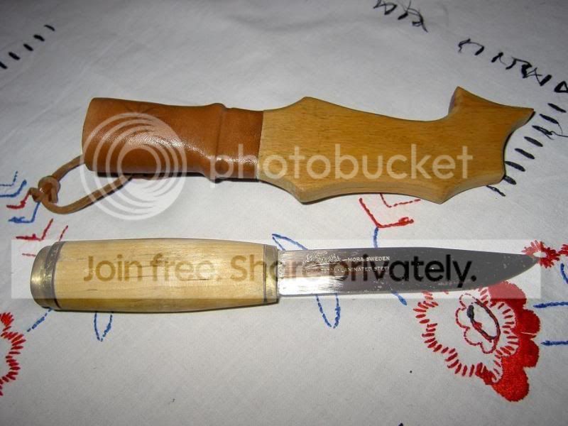

The laminated moras are made of Uddeholm UHB 2140/Arne (eq. to AISI O1).
