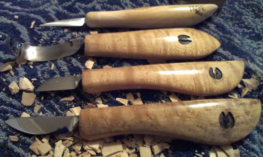

These are some of the blade profiles on my forged carvers. Minus the spoon carver of course.
There's a reflection on the blade on the bottom knife in the pic btw. The edge is straight, not recurved.
I know absolutely squat about carving but those are some fine looking pieces of cutlery.
