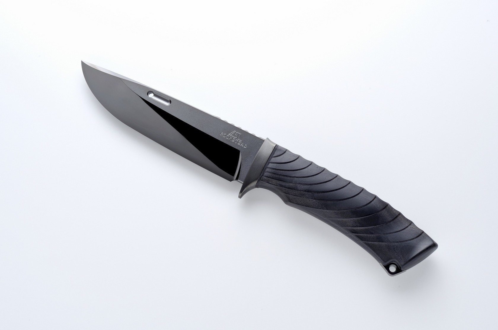

It’s probably too much of a pain to do on these but the best effect I have ever seen on steel to create an obsidian like finish is actually polished DLC.
I have seen some outstanding knives with this finish and it creates a very polished hematite kind of look.
Like this and it reflects like a mirror.

... the best effect I have ever seen on steel to create an obsidian like finish is actually polished DLC.
Did a quick google search as I've never heard of this and I'm curious if this is something one can do in their shop or do you have to send the blade to a place that does this (which is what it looks like to me so far....)?
Yes, thanks. I thought it was going to be much more complicated than that.
I’m not sure how you would do it. I think you would have to send the knives to get dlc coated and then polish it yourself.
The principle of the stonewash is not complicated, the devil lies within the details, as with most things in knifemaking. Regarding the Rockstead knife: u are right that finish looks more like obsidian.
I am also curious how they do it. Because if they polish it after it was coated, I don't understand how they get that surface without a single scratch on it. Or they polish up the blade to a mirror finish before dlc coating and then just give it a very light, thin coat....
But I dare say that a stonewashed or acidwashed finish will look better when the knife is actually used, because any scratch on the rockstead blade will be immediately noticable.
