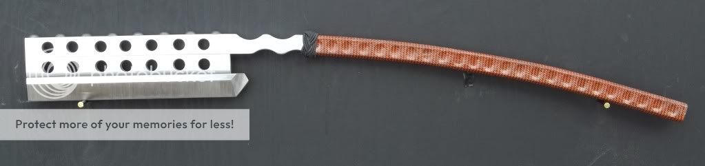

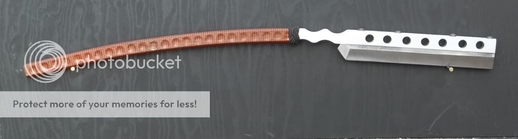

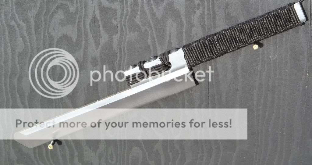

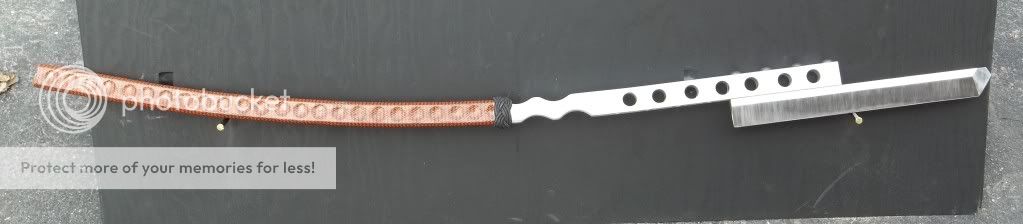

Bringing this puppy to Blade! Multi configuration...
blade material and hardness: S-7 RC 58
blade surface finish: machine satin
handle material: 6061 aluminum alloy, carbon fiber hybrid skin
other materials: grade 8 socket bolts
overall length: 42 1/2" (13 7/8" blade)
maximum blade thickness: 0.52"
weight: 5lb 12.5oz
special features: durable aircraft aluminum handle has a carbon fiber hybrid orange composite skin for comfort and abrasion resistance, head can be mounted on inside (for chopping) or outside (for slashing) of curve, also using accessory bolts blade can be mounted without spacer as naginata, bayonet, or poleaxe, vibration isolation zone, armageddon-ready survival tool/weapon
Haven't tested this very hard yet, but I have tested the construction method pretty hard, and the S-7 this batch came from too. I didn't want to scratch them up before the show.
Pretty much everything I do is one-off except for my Baby hatchets, but if response is good in Atlanta then more will be coming!
