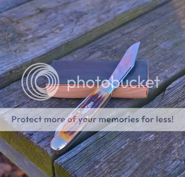

Recently, Kevin (richstag) had a very generous giveaway, the prize being a beautiful handmade strop he crafted, and Johnny Twoshoes was the lucky winner. What struck me about the strop, aside from its obvious quality and good looks, was that it was designed to fit comfortably in the palm. I had been told that a strop (or hone, as some prefer) should always be used lying flat on a bench or table, to better assure a consistent angle on the blade. But I had found myself often picking up my strops anyway, and tilting the angle a bit as I stropped through the curve of a knife. It made sense to me, and it felt comfortable and right, especially with small knives like traditional folders.
So, I was determined to come up with something palm sized to try out. While I would love to have something of quality like Kevin's creation, I have neither the talent nor the tools to do it right. But, I wasn't going to let that stop me! So, last week as I was walking my dog (Mia the rescue pointer in my avatar), and contemplating all this, I noticed a small piece of wood on the roadside. I picked it up, and when I got home, paired it with a strip of scrap leather that was salvage from an old pair of boots I'd worn out. Once the glue had dried, I striped on some Bark River green and gave it a whirl---not bad! I had never tried a strop with suede leather before, but it seems to do alright, and it holds the compound well. A day or two later, I decided a bare strip would be a good addition to finish on (and clean off any compound residue), so I added a second strip on the adjoining side, this time using the smoother side of the leather. I sanded the rough edges of the wood block for all of about 5 minutes, and done.
You know, it's not going to win any beauty pageants, but this little palm strop is functional, and has reinforced my suspicion that, especially for small knives, this is not a bad way to go. And the cost---about 10 cents for glue and a little compound.
So, here is my little crude palm strop posing with my newest acquistion (which did, I'm afraid, cost more than 10 cents): a GEC Northfield #66 serpentine jack in rotten banana bone. I had wanted one of these ever since I saw lambertiana's great pics of his in this thread: http://www.bladeforums.com/forums/s...-vs-GEC-56-Dog-Leg-Jack-vs-66-Serpentine-Jack I had problems locating one, at a decent price anyway, but finally got lucky and, with the help of a kind dealer, snagged it. I'm pleased as punch with it, as Hubert Humphrey used to say, but its attributes are worthy of another thread, so I'll leave it at that for now.
Anyway, thanks to Kevin for the strop inspiration (and to lambertiana for the banana inspiration!).
Andrew

All of my strop blocks are sized similarly (~5-1/2" x 2-1/2" x 1/2" red oak, and leather), for the same reason. I've made three of them, each with different compounds. I did make one that's bench-sized, but I've hardly used it. I also have a 'pocket-sized' strop block, of a smaller piece of red oak and fairly thick, very firm leather. I've put 1 micron diamond paste on both sides. Lately, that's the one I've been using the most. All of my freehand habits were built on using a Spyderco DoubleStuff pocket hone, which I used held in one hand, while honing the blade with the other. That's what my hands 'learned', so virtually all my hones & strops used since have been chosen, made and used on that basis.
Functionality is what it's all about. I've also used some balsa blocks with printer paper wrapped around them (stapled in place), with compound applied to the paper. The first time I did this was basically a fluke. I'd just applied some diamond paste to one of my 'real' strop blocks, and didn't want to waste the excess compound. Grabbed a piece of paper to wipe the compound on, then looked for a suitable flat 'object' to use that on; the balsa block was just 'there'. Spur-of-the-moment, dirt cheap and infinitely simple. Works great.
David, thanks for your comments. I respect your knowledge, so this further confirms my impression that a hand held sharpener can have real advantages.
Andrew

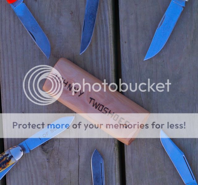

I don't know how he did it, but Kevin hand fitted the strop he made for me, it's perfect. I have really changed the quality of my edge by using this strop, I love how it adds that extra bite, that scariness. :thumbup:
I call it Kevin's Coffee Strop, because it wakes up all of my knives.

Thanks, gents, for all the comments. Johnny, thanks for those pics of your strop from Kevin---it looks great.
Andrew
