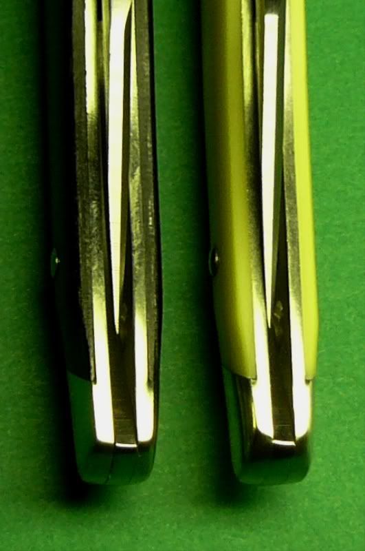

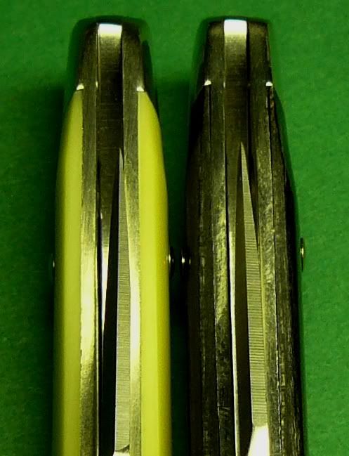

These 301s, with the pointy single blades and the beautiful blue/silver shields, are cool.
Is there some technique for me to try on the yellow one to help center the blade? I have a vice but lets keep it about the knife... :D THX
Anything you do may make the blade rivet show. "ring around the rivet" The easiest way to center a blade is to open the blade, lay it on a bench at a slight angle an hit it with a rubber mallot gently. Check it, do it again until the blade is centered. But, you may get the blade rivet ring. Send it back to Buck would be your best bet.:)

Jeesh, that looks awful. I'd send it back. Is there any blade play when it's open or closed? If there is play, that might be the culprit. I'd give it a tap with a hammer and something to protect both sides of the bolster. I had to do that to a Case sodbuster and a Rough rider canoe. Both instances eliminated the blade play.

No blade play open or closed. It is a brilliant slip joint. The position of the closed blade just gives me the fidgets.
I'd hate to send such an affordable knife back to the manufacturer. That's why I fixed my Sodbuster Jr. myself, granted it was very slight blade play that was probably within their tolerances. Your knife though is unacceptable IMO at any price point. Does it touch the liner?

The closed blade lays right on the liner.
I'm gonna work some alcohol thru the pivot, clean it, lube it with mineral oil and see how that works.
