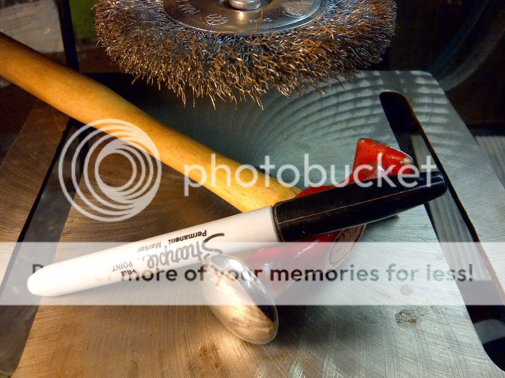

Here you go,
I also started using a sharpie to mark just the pin so its more contrast to line it up on the anvil and hit with the hammer.
With this hammer I will not get dings and if the bolster gets a little dented I can actually use it to smooth it out right.

I just went to the hardware store several times since then, but I always forgot about a hammer like this. Bought screws, nails, new chainsaw-chain but never such a hammer... I should better write a note to myself... ;)
Richstag, ive used your method on some soddies and it always works.
