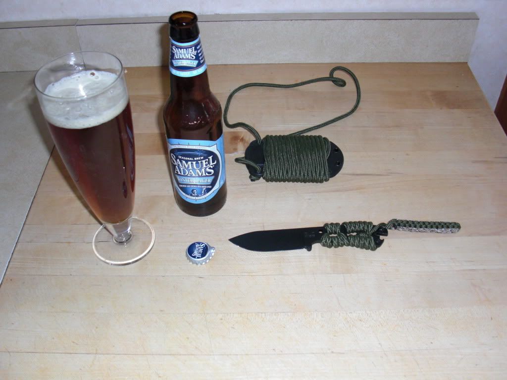

Here is some more: The BK-11 tang has the Wire Breaker/CapLifter so that Tang is a bit harder. (52-54Rc) This is so there is sufficient strength and wear resistence on that feature. It would be a sad day indeed, if you couldn't enjoy a brewski because the Lifter was worn out.
Thank you, paul. You have saved all BK11 owners the sorrow of ever having to experience such a hardship. :D
