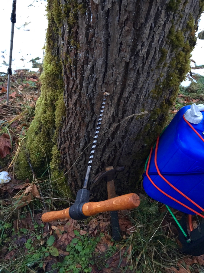

It's that time of year again in the PNW, time to tap our maples and make syrup! It's hard to tie this in well with an axe forum but I thought a few of you might enjoy this anyway. There is a hatchet photo involved plus T-handle auger use.
Almost no one taps up here because we don't have sugar maples. But we have an abundance of Oregon Big Leaf Maples. Our maples don't have as high of sugar content so it takes more sap to make syrup. My sap typically boils down about 40:1 into syrup. So a 5-gallon jug of sap makes a pint of syrup. Sugar maple sap reduces about 25:1 to 20:1.
I'll start with some of the equipment I use. It starts with a 7/16" auger. Sometimes I use a T-handle, sometimes I use a bit & brace and sometimes I use a power drill.
I buy stainless steel spiles from Lehman's. I'm running just 10 taps. I also bring a claw hammer for driving or pulling spiles and sometimes a saw or hatchet. I strap a 5 gallon water jug to a pack frame to go collect my sap. Some days I have to wear snowshoes.
The T-handle auger is slower than the bit and brace but it's also lighter and takes up less space. Today I was just moving a few taps so I used the T-handle.

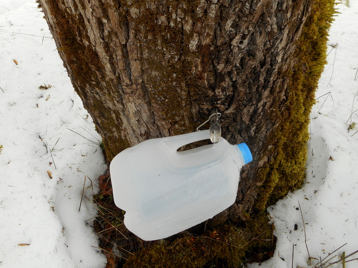

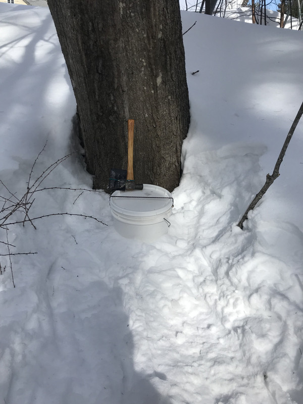

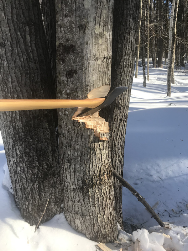

When the weather is right and the sap is flowing you sometimes have a drip going before you can get the jug under the tap. Note the little hatchet leaning against the tree. Sometimes if the bark is thick or mossy I'll shave it off with a hatchet. That one is a Craftsman (Vaughan).
I slip the hook into a small hole I made in the handle.

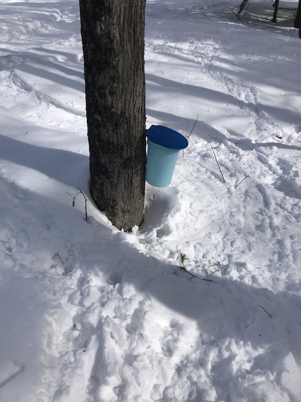

Then I twist the jug under the spile.
Each tree is different. In good weather some trees will produce a gallon a day. Others might only give up a quart. I 'prospect' and try new trees if one isn't producing well.

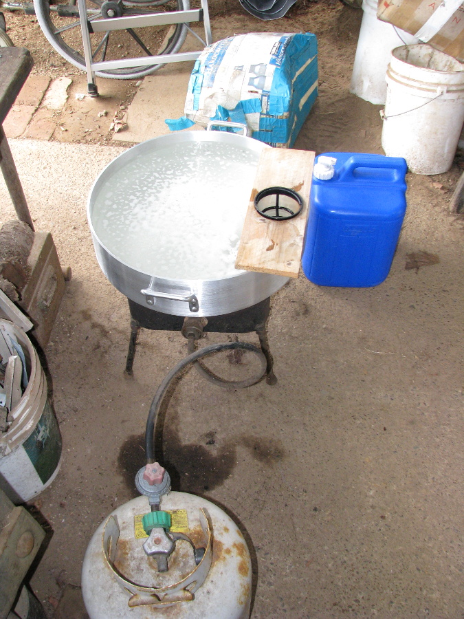

I boil on weekends. A good week will produce 15 gallons of sap which makes 3 pints of syrup. I strain my sap through a fine mesh coffee filter and boil it in a 20"d pan over the burner for a turkey deep fryer. The larger your pan the faster if boils down because there is more surface area to steam off of.
I've been doing this for 10 years and it just dawned on me today that I could effectively increase the size of my pan (at least the evaporation rate) by blowing a fan on it. This worked well and saved a good bit of fuel.
Once it's been mostly reduced I bring it into the kitchen to finish it. I want to watch it closely as it's finishing. Maple syrup has a higher boiling point than water. As you boil your sap and concentrate the sugars the boiling point increases. Syrup is done when it reaches 7°F above the boiling point of water at your elevation. The boiling point of water decreases by about 1°F for every 500' above sea level. I'm about 500' above sea level so I take mine up to 218°F. Then I can it in sterile jars just like canning jelly or anything else.
