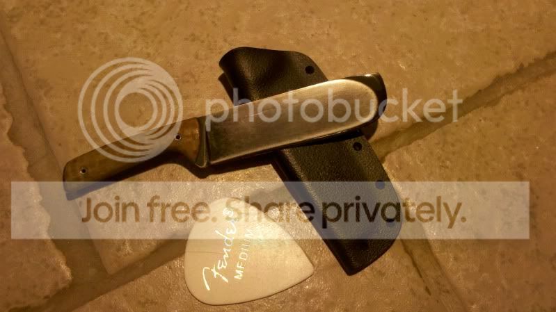

It is a 1:4 scale chopper. The original is about a foot long, .250" thick, and has 1/4" tubes. This one is about 3" long, 1/16" thick and has 1/16" tubes.
It is made of differentially hardened O1 Steel; the spine and handle are slightly softer. The pins are aluminum and the sheath is concealex that I ground down thin so it is close to scale.
I made the scale material, burlap mycarta. I tried to make the mycarta glow in the dark and it has a very faint glow.

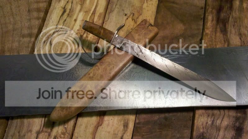

Wow....I just found this thread lol...I got one i will post here.
Blade: Tight twist cable damascus
Guard/Pommel: 1080/15n20 damascus
Handle/Scabbard: Honey Locust Burl, Tung oil coated, CA sealed and sanded to 1000 then buffed.
Glad this went to a good home, Enjoy it Charles!

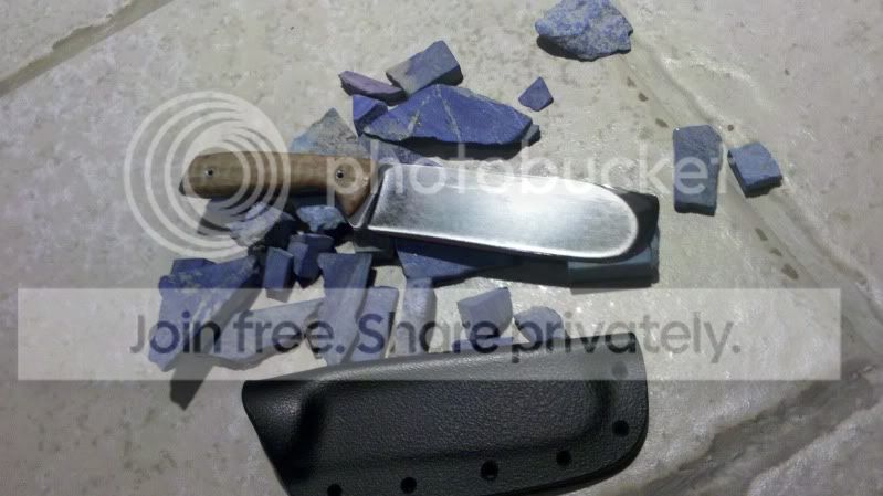

I posted in the KITH thread already, but i wanted to post this here also! I am stoked to get this!
He also sent me some Lapis to play with! Thanks a ton Daniel, this is awesome!

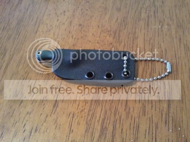

I posted some pics in the sticky but I will post here as well.
I am super excited to get this knife! This event was so much fun!

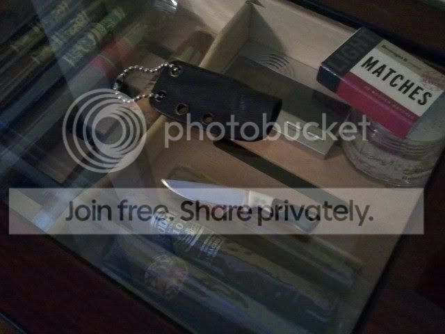

And this is where it will live. Atop the humidor on my bar displayed proudly for all to see.
Thanks again Ryan!
