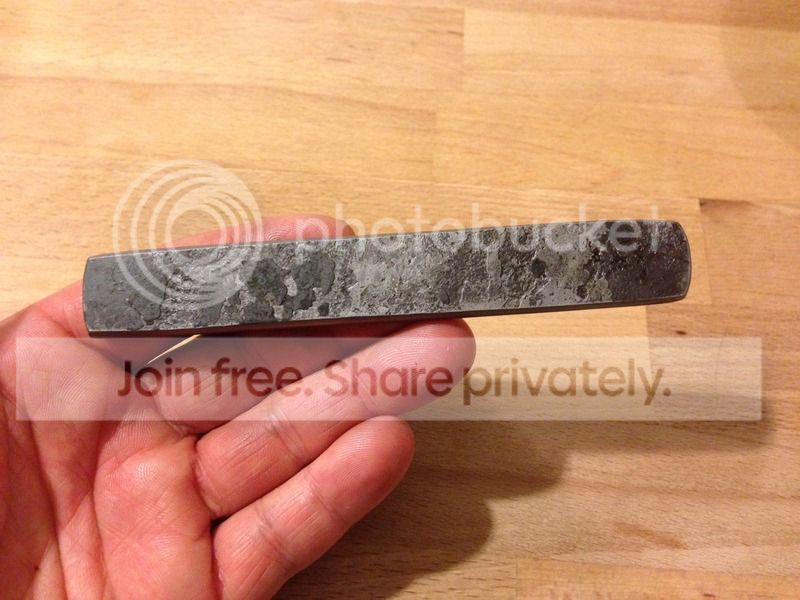

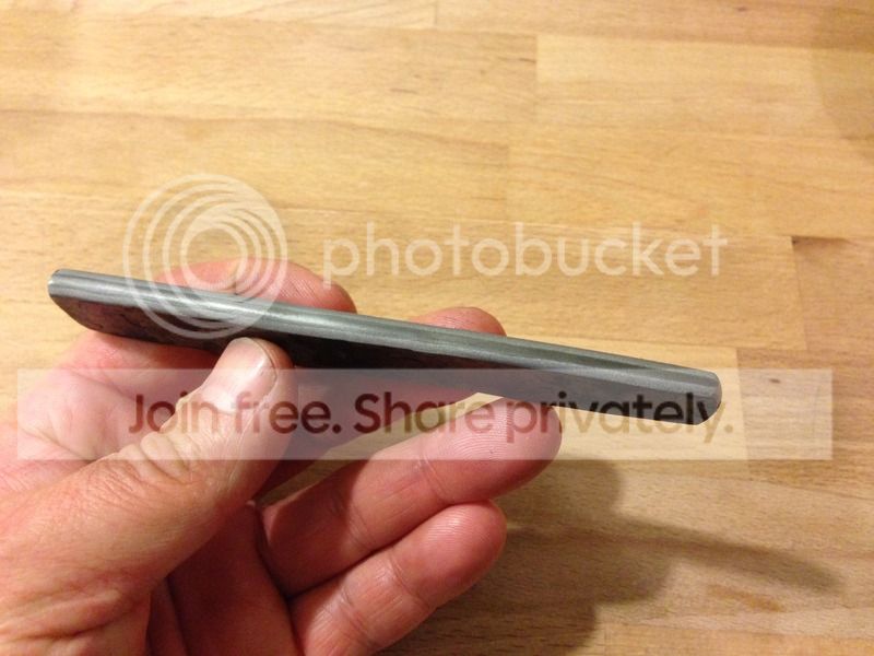

I forge-welded this tiny billet of mild steel with a 52100 core. It will be a small kitchen knife in the near future. For now, it is just a vinegar etched billet.
Oh yeah... In the process, I also melted the lining of my forge. Note to self, don't crank it up past 7PSI.

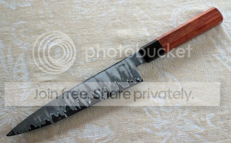

I was looking in nearly every nook and cranny and found two billets of stainless/1095 san mai that I had prepared for forging......months ago. I had completely forgotten about them.
So - one of them is now nearly complete and is a hunter with early 20th century Bakelite and will have a hot blued guard.
I'll post it up before the Blade Show.

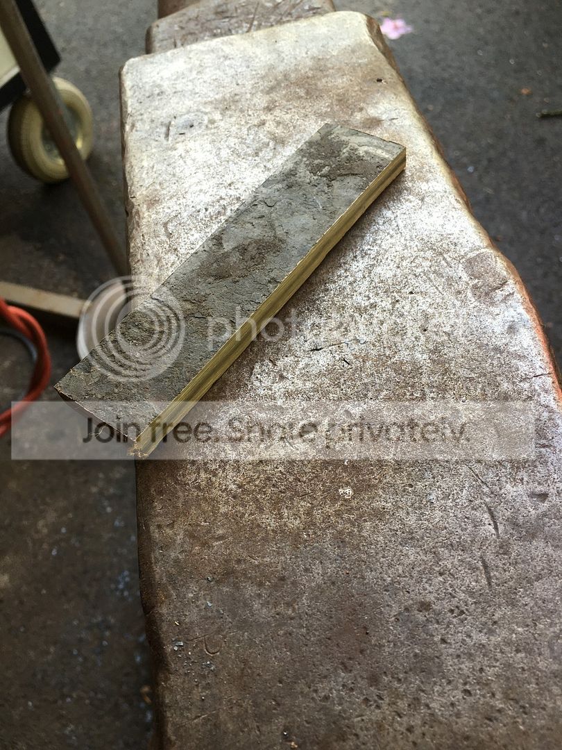

I went to town today to pick up some forge welding "supplies":

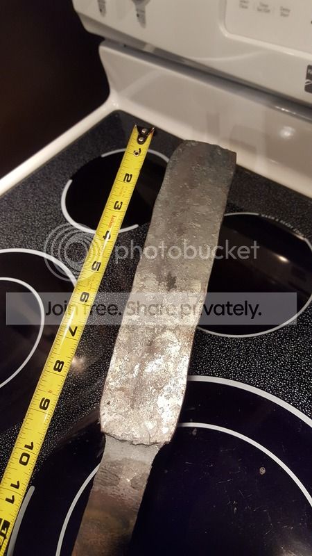

Hopefully these 3 pieces of steel are a Sans Mai billet later tonight:
The san mai billet appears to have welded up, will find out later when I split it into two and clean up the edges.

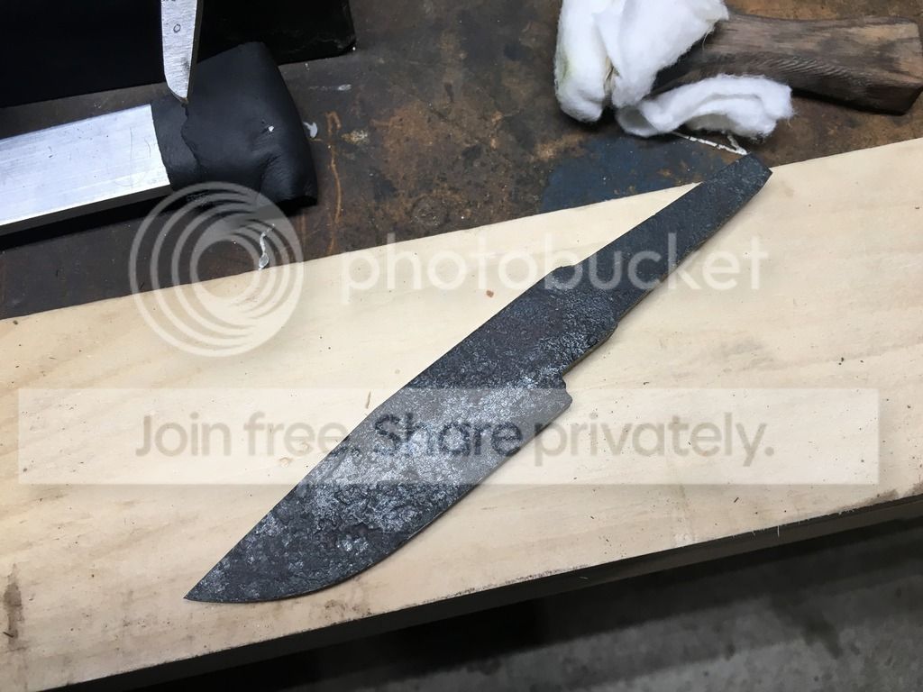

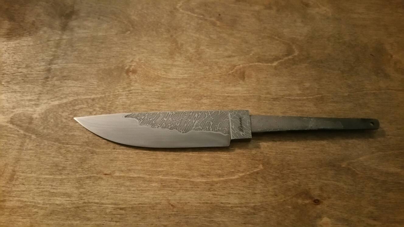

I started a thread on this but for future posterity I will put it here to. I also need to publicly thank Mr. Andersen for the help he provided in answering all my questions.
303 sides and W2 core.
Stacked ready to weld
All drawn out
Showing the side
End
profiled
Ground, heat treated and test etched.

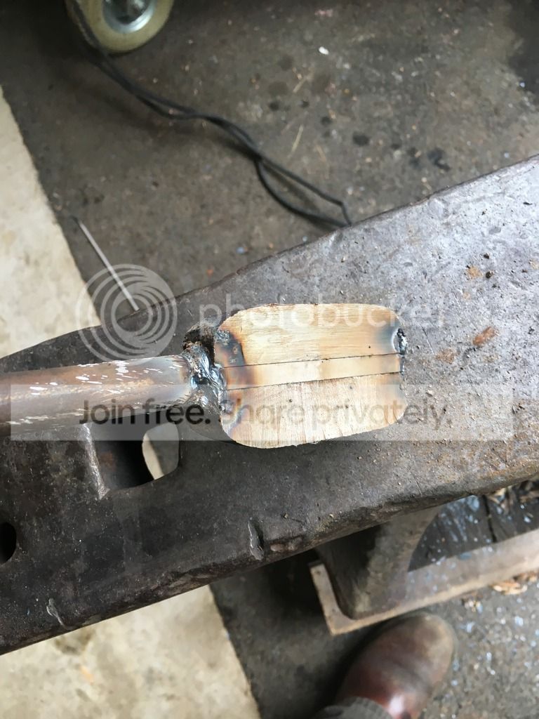

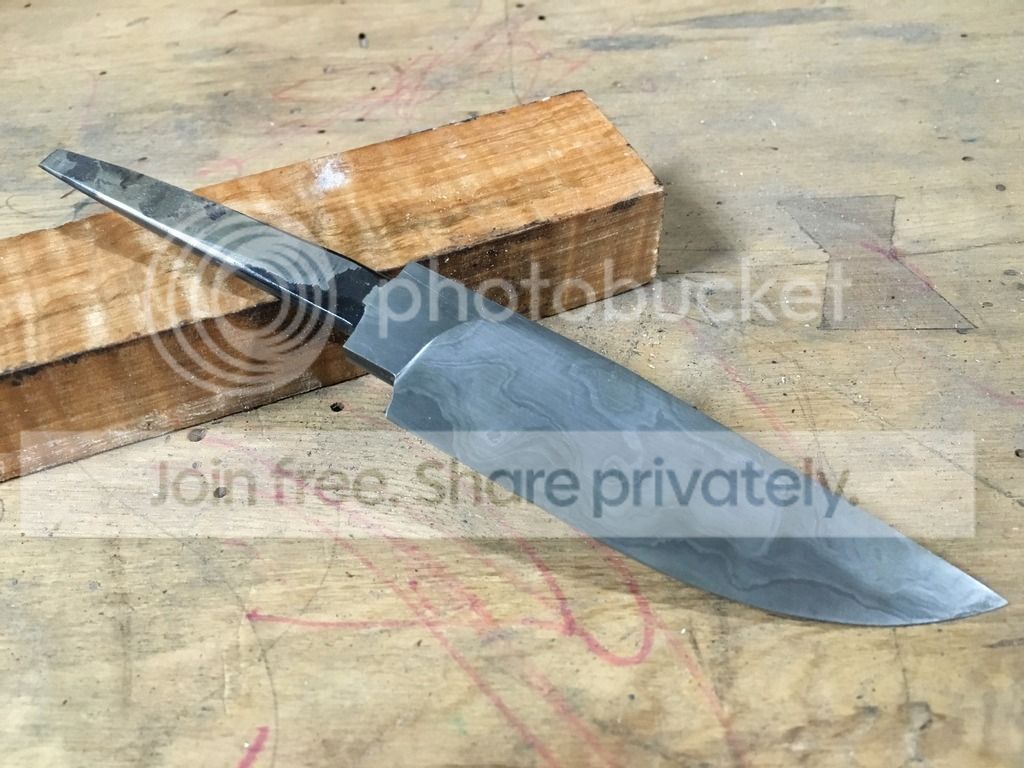

Welded up my first billet this past Sunday with wrought and a 1084 core.
I think I will double up on the 1/4" 1084 on the next one...?

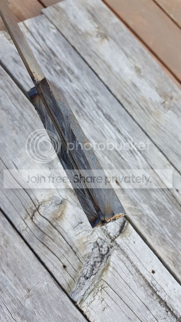

I used cable and 52100. I know there are a lot of hard feelings towards cable,but I work on the river and it's free to me. Also, when I make a knife for someone out here, they want a cable knife. Noticed that my outside billed is not ending up as close the edge as I would like it to be. Do I need to draw it a little thinner so I'm not grinding it all off?
Sent from my SM-N910V using Tapatalk
Really like the looks of the cable San Mai. I'll be forging a billet of that very soon.
Thanks for posting the pic, Fred
Matthew - that cable looks awesome!
To have it closer to the edge I think you have to use a thinner core (52100) relative to the outside layers (cable)....but I'm a san mai newbie😀
Thanks guys, I will try a thinner core next time. Should've come to me sooner because the cable moves like butter while the 52100 hardly moves at all when drawing out. If anyone would like cable I could be somewhat of a small supplier. We are always breaking them at work, and I pack em home. Most of it is 1 1/8 with rope core or wire core.
