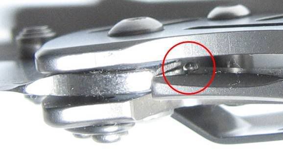

BTW: Ball detent

Generally, this type of problem is not all that rare on lock formats that use a ball detent as the closure mechanism (liner locks, framelocks, compression locks). Much rare with lock formats that use some type of direct or indirect spring pressure (lockbacks, axis lock, ball lock). A ball detent mechanism *should* work fine, but is often difficult to get right
