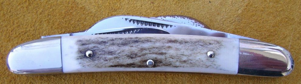

This oddity from Bulldog may well be Cell even if it's 2008....:eek:
Can't take the risk, I'll get it re-handled as I like the Saddlehorn but that colour is not only potentially lethal, it's revolting:barf::D
Otherwise it's really nicely put together and sharp.:thumbup:

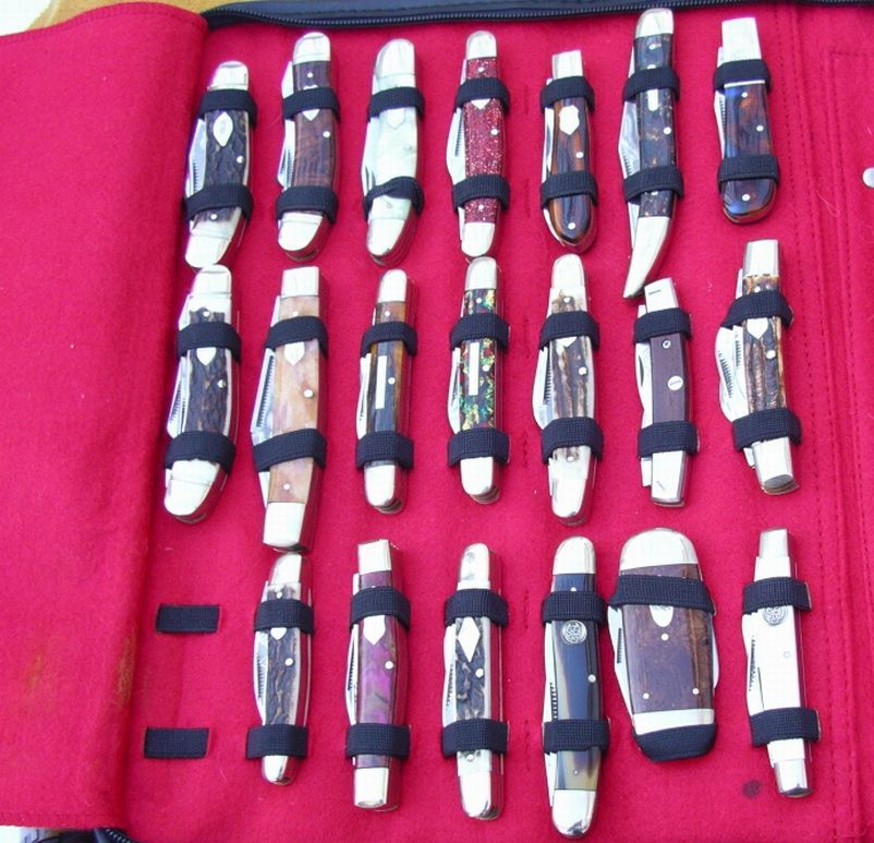

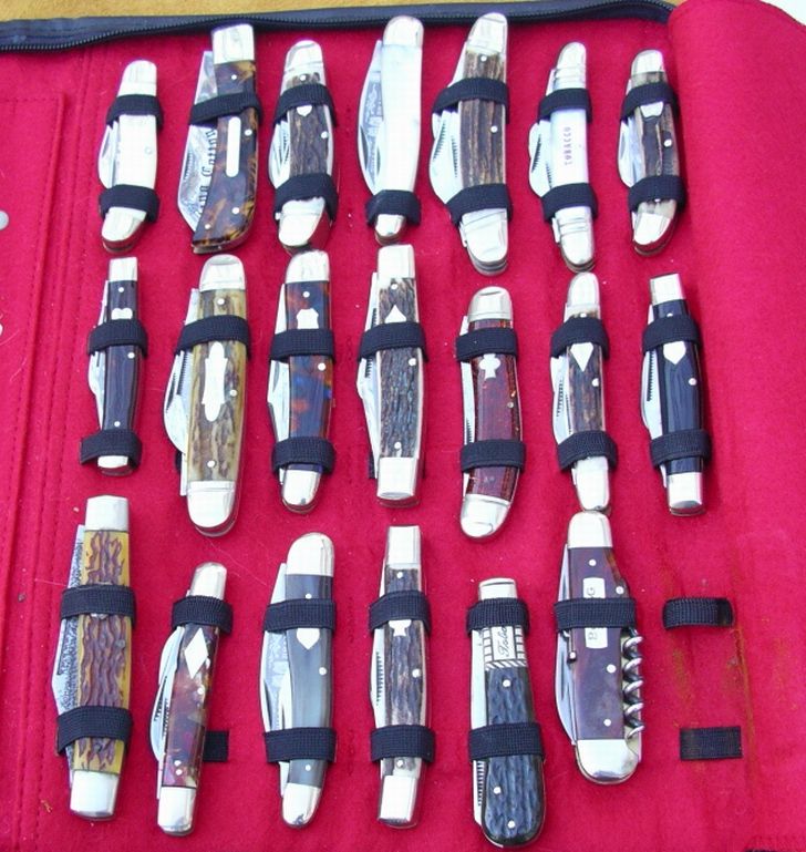

In this instance it looks like only 2 knives gassed off and they affected 1 other knife. This storage case was in a gun safe which is packed full with knives in storage cases, knife rolls, and lying loose in open top plastic containers. The damage seems limited to just the knives shown in that 1 storage case. I have another gun safe which similarly is packed with knives but this is located in my 'bush cabin' and i will check it when i next go up there. I also have knives in knife rolls stacked on book shelves (no books, just knives). There are cell handled knives scattered throughout many of these storage cases and knife rolls. I need to go through all of these stored knives and remove all cell handled knives and check all other knives for damage. There are about 10,000 knives to check so this inspection will be ongoing for some time.

Oh buddy, you have a BIG job ahead of you. Glad you caught it now.

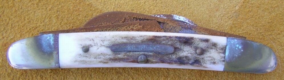

I am trying to bring some order to the great many knives that lie about my house. I came across a storage case labelled "Bulldog" and since i have not looked at them for at least 2 years, decided to.
To my great surprise i found this:
It was in the now vacant slot lower left corner:
But as i looked at all the other knives, no others here showed any gas effect.
The side that was down is much less affected:

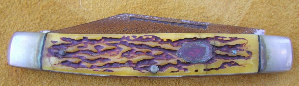

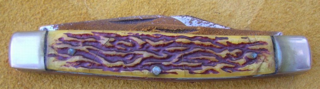

I then looked at the other side of the case and found this knife:
And, both sides are equally affected and the handles are an imitation Stag that i now realize must be celluloid.
Here you can see that it came from the lower right corner slot:
These 2 knives were lying one on top of the other but with 2 sheets of red felt cloth in between them. You can see one other knife with similar handles starting to off gas
I am going to throw out the 2 gaseous knives and clean up the Stag Congress and then take out all other cell handled Bulldogs and put them in a separate storage case.
But the work does not end there. I have 5 or 6 storage cases of Fight'n Rooster knives and celluloid is perhaps the most common handle material in these knives.
So, maybe you too should check your dogs and roosters !
