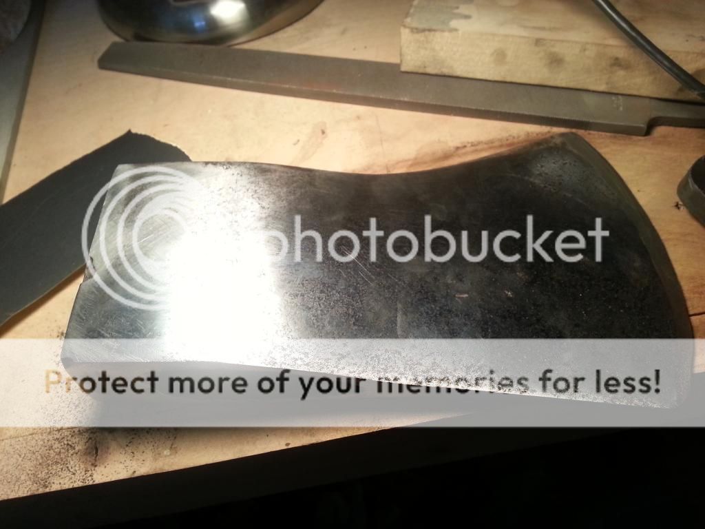

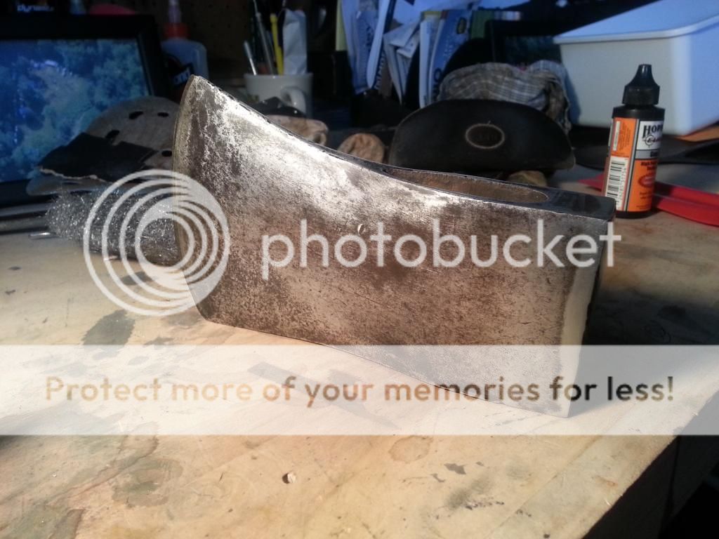

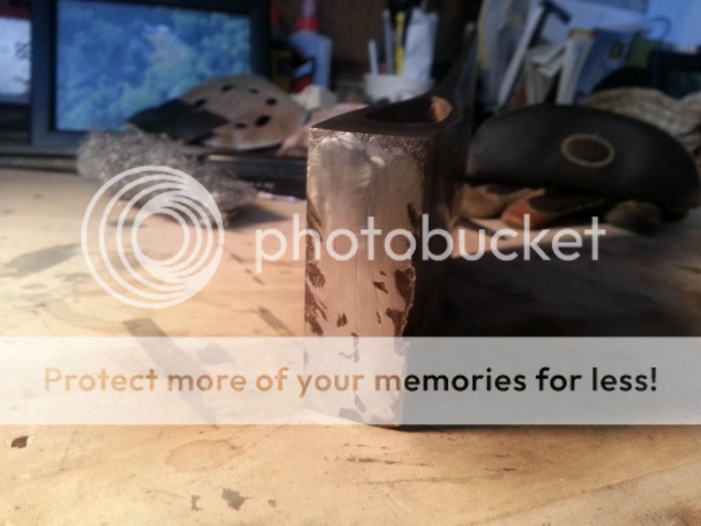

Here's what I've been working on. A 3 1/2# I received from Curt Hal.
All the work has been done with file and various grit sandpaper. About 6-8 hours in it so far.

Nice work! Looks great. i do almost all my work with the files and sandpaper, so have great admiration for your approach. I have recently started respecting the effect of the wire cup and the drill or grinder, leaving the patina.
Those butt mushrooms were pretty substantial. Nice work filing them off so square!

One thing I learned the hard way too: take the time to see that the handle fits nicely into the eye before hammering the bottom of the handle to set it. When I first started, I wanted to get a super tight fit between the handle and the eye. In the process, I made it too tight and couldn't get good wedge penetration, and I cracked a couple of nice handles trying to pound them in.

totally possible to bring it back but you would end up with a smaller head, which is no big deal since it was huge to begin with. Just be cautious with the over heating and in keeping everything flat and square.
or you could leave as is and hang on a wall.
As I look at it, I see a line where the hardened meets the mild. I am afraid of snapping it with use.
A broad axe doesn't get subjected to hurricane forces the way a felling axe does. I wouldn't be worried about breaking off the bit or anything. The issues I see with that axe are the pitting and the profile. From the picture it looks like the center of the bit is filed back. Thats a problem, but it may go away by the time you get rid of all the pitting. Pitting on the bevel is not important, but really heavy pitting on the flat means you have to remove a lot of metal to get a sharpenable edge.
if its double bevel (god, why do some people ruin such good broad axes?) then you will already have to remove alot of material to make it flat again. it is a risky (if using power sander, cool down in water alot and often) and lenghty restauration, but it might be worth it in the end. whatever you do, dont use angle grinder or handheld grinder, these turn way too fast and will burn the steel/remove the heat treatment. Im afraid you are heading down a long and painful road if you want to fix this head...
