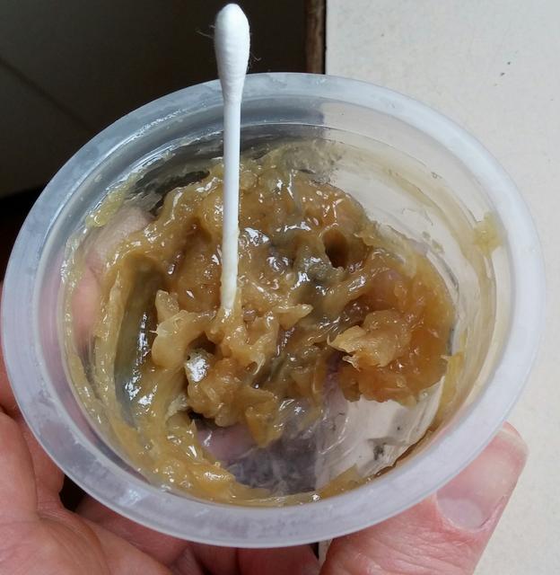

Petroleum jelly/vaseline, is like butter or coconut oil, its grease,
it doesn't take much heat to melt it,
you can use a hair dryer, its what I used
Petrolatum melt point is 37 °C (99 °F)
to seal all 6 sides of a stone,
takes less than 1 teaspoon petrolatum
to load/saturate a stone might take a few oz
ex 2oz aka 12 teaspoons

Ditto to the suggestion for Vaseline (petroleum jelly). I've done a couple of my stones in SiC with it. Real simple. Just spread some on the stone like it was butter or cake frosting, and heat it. I used a heat gun for this; don't need too much heat to make this work, so keep the nozzle of the heat gun at a conservative distance from the stone, on the lowest heat setting. The stone will get pretty warm; try to keep it moderate enough so it's not too hot to touch with your bare hands. When the Vaseline melts to a clear liquid, the stone just drinks it up like a sponge. As with the oil, the stone will absorb a LOT of it too; so don't worry too much about applying more, if you want to. After discontinuing the heat, it'll cool & thicken quickly enough within the stone to seal it up very effectively. Put some towels down under the stone, as the process is a bit messy for whatever work surface you're using.
