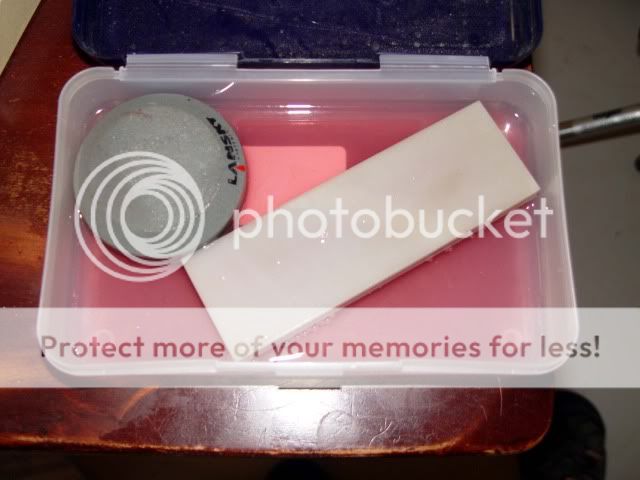

Hey Guys,
I've left my stones in a honing oil solution soak so that they become saturated with oil, thereby using less oil later. I'm pretty sure this is a normal and widely accepted practice, but my question is how long do you usually let yours soak for.
Also, I've done the same with the Lansky Axe puck. WOW is this thing porous!!!!

We used a heavy weight oil (90 weight or so) or melted grease to soak oil stones and SiC stones.
Seems to make the stones cut to a finer finish as well as preventing the honing oil from soaking in.
Overnight was the general practice for oil and a few hours for the melted grease (morning to the end of the workday).
that grease sounds like a good idea to prevent the clogging. The oil keeps the metal from clogging up the pores, and more oil is used to clean it off. It also helps prevent the metal deposits that might or might not be left over from oxidation. I started using this honing oil on my diamond stones too when I am at home, works great and I can go longer without de-clogging. I'm not sure what the puck is made out of, your normal abrasive (not diamond).
Never tried leaving oil stones soaked in water. I've heard the thinner oils help break vitrified bonds and the thicker oils are better at floating away swarf. Whatever and whichever, I use a shot of Ballistol and Bill DeShivs has great things to say about WD-40 for use on oilstones and diamonds (he uses it on buffing wheels, too).
