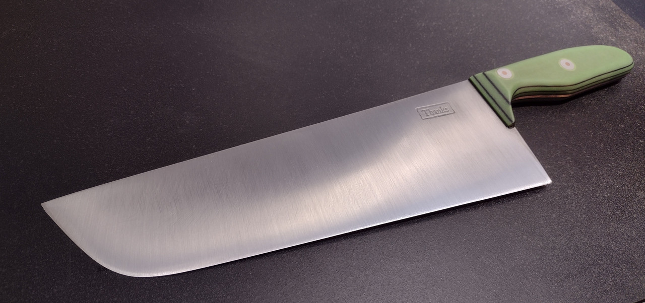

I normally make my blades out of higher alloy, air hardened steels....
I got a batch of 8670 from Bos. First time working with the steel. So far I like it. Another fun steel to work with.
But, I don't think I've made anything dipped before?
I almost screwed it up majorly, and wanted to make a post for the new makers.

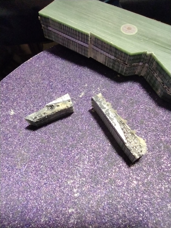

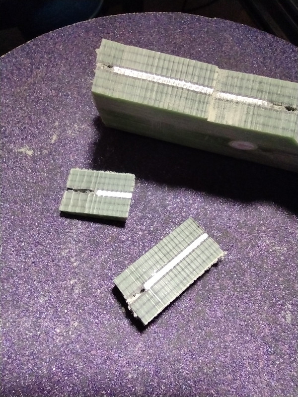

Normally I cut around the perimeter of the handle the next day, after it is cured.
Look what I did.
You can see I cut into the steel.
Normally I rely by sound and feel, but lost track where the steel tang was.
On air hardened steel the tangs are at full hardness. I guess this isn't true for oil quenched blades?
Fortunately, it was on the underside. I only cut into the handle a little bit.... And it was for my wife.... I was able to work around it. But it really threw me for a loop, because I knew how hard the knife edge was, it took awhile to grind and sharpen. I was going crazy, then it dawned on me that it was dipped, and that must effect the blanks overall?

The handle should be mostly hardened as well if they were heat treated in a kiln, the only spot that may be slightly softer would be the very end of the knife where pliers or tongs held it but even then a steel like 8670 is pretty deep hardening and shouldn’t be able to cut it like that if it was properly hardened. I’d be calling Bos. and asking exactly how they processed the blades.

I could feel by sawing closer to ricasso area Was hard, but as you said at the rear/bottom was where I accidentally cut off.
The blade was definitely Very Hard, I just was surprised the butt wasnt. I'm sure the new bandsaw blade was a new blade No More.....

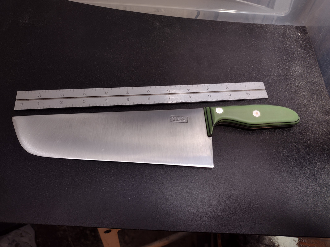

If Bos fixes a warp, there will be a “Q” marking the high point of warp. I know there is a maximum length of 12” tip-to-butt for oil quench. From your picture it appears over all length is about 14”. If you hit the handle some where from 2-3 inches from butt, that probably is your answer.

Side note: the edge of a kitchen knife should never be straight. There should always be a slight curve to it.
Hoss
I have that large radius, it helps with rocking, chopping, and push cuts.
