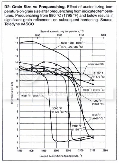

There's an intriguing chart in the ASM Heat Treater's Guide that shows a radical grain size reduction with a dual quench with reducing temperatures. I'm at work and can't look it up right now, but they reference a technical paper from one of the defense contractors who did extensive studies on the initial austentizing temperature, the secondary austentizing temperature, and the resulting grain size.
I just realized your second link was to an online version of the ASM Heat Treater's Guide. This is the chart I was talking about. "Prequenching" is the industry term for a double-quench.

I have done that. And, looking at broken test coupons, it appears to my eye that it does reduce grain size. Hardly a definitive test, I know. However, that said, thorough blind testing of treated test blades and "regular" blades I found no difference in actual performance in a variety of mediums and techniques when used as a thin knife.
In my opinion, prequenching D2 doesn't hurt anything. But, like full cryo, has not resulted in any noticeable improvements in the finished blade that I can see. I've retained test sample blades if any peer wants to review them.
One needs to be very careful double austenitizing D2 because it is one of the steels that can experience extreme grain growth on a second heat. Something to think about when you consider the thin edges and our electric hot air ovens and the potential for considerable unintended (and unobserved) overshoot in areas.
