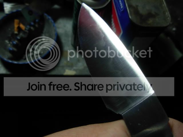

Danbo,
I've been getting my but kicked by Hamon also, LOL. I think I've got my problem nailed down though and will be HT-ing again this weekend.
I thought I'd mention what I've been doing to check what I've got after hardening.
-I get the blade clean with a couple passes on an old 80
-A pass on an old 220
-A pass on an old 400
-A couple passes on a 600 grit cork
Takes less than 5 minutes total and gives a crystal clear look at the hamon.
Probably don't need to go this far once more experience is gained but being new to hamon I wanna see exactly what I've got before tempering.
This is what you can see after cleaning up-

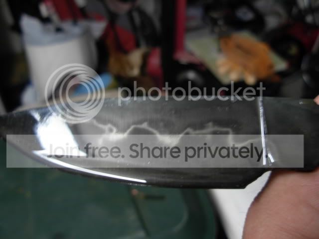

After a 20 second dip in the ferric-
Take care, Josh

That's a pretty nice Hamon on that blade of yours! :thumbup:
Thanks,
Yeah that one came out great but was followed by 2 failures , LOL
Still working on it though ;)
Mainly wanted to show that it's not hard to get a clear visual of the hamon without too much effort.
-Josh
