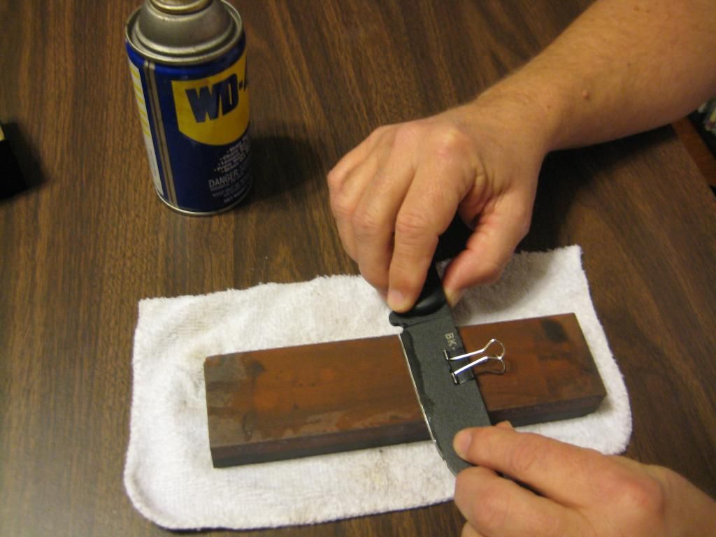

Can't get much simpler than this. Put a quarter inch binder clip on the spine to hold a consistent angle and have at it. :thumbup:

Did ya measure the angle?
