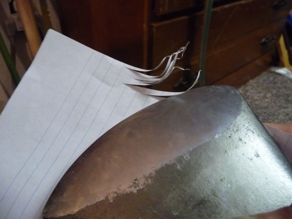

Do all the reprofiling with a file and be 100% sure to RAISE A BUR! That's the easiest way to know that you have the two sides of the blade forming a nice edge and have zero flat spots. Only then should you move onto a stone to eliminate the burr and establish a keen edge. After that, strop the thing on a leather belt if you really want it to get razor sharp.
Here's a post of mine that you might find helpful - I was restoring a 3.5lb SB Keen Kutter and sort of explained my methods for sharpening:
http://www.bladeforums.com/forums/showpost.php?p=9232810&postcount=15
