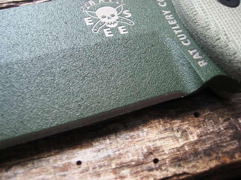

OK, lets compare and see what the hell we're talking about here..
This is the best shot I could find of the Breeden at question.
You can make out both bevels.
Here is a good shot at a Scandi grind no one will question.
and here is a Saber grind.
So now what say you....
I'm leaning towards the sharpest saber grind I have seen!
Yep, seems like a sabre to me.
And, a damn fine looking knife!
Semantically yours,
- Mike
