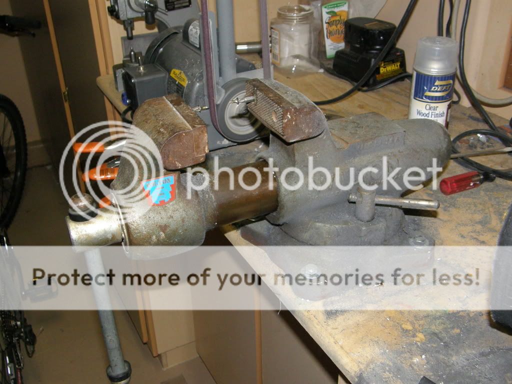

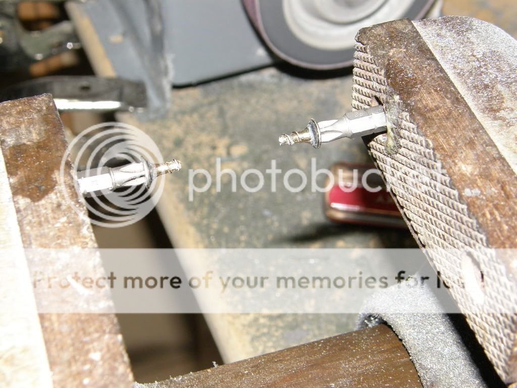

I have to thank Ban for his help he suggested sheetrock screw heads for a die I used deck screws figuaring they would be stronger. Then I needed a press. Ban said something about a Wilton vise but didn't tell me how he used it. I hope I am not giving away any secrets if so I am eternally sorry. The problem how to hold the whole setup in alignment. I pressed regular phillips head bits #2 in to the deck screw head and it seems to hold. Then I was trying to hold my knife and the homemade dies in alignment between the jaws of my vise. A real juggling act and it didn't work at all well. I started to think about drilling holes in the jaw face when I noticed the faces were held on by Allen bolts and sure enough the bit fit perfectly in to the hole for the Allen key. Now all was in decent alignment I put the rivets in the holes and put it between the dies. After several tries feeling for any looseness in the rivets I finally had the feel of it. Here is my setup very homeower style. It did work though.

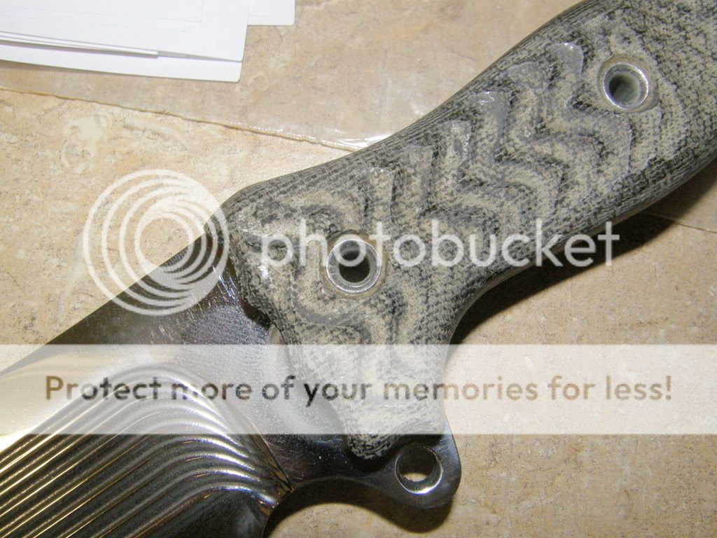

Lets see closeups of the fasteners please. Did they flare out ok? Did they tear any?
Nice vise! That is the exact same one that I use. The way you have it setup with the screw head is pretty good. I use to just use finger dexterity to hold everything together then closing the vise. I make final adjustment and alignment by twisting the knife to move the screws. BTW, you may want to consider shortening the screw tabs a bit. They may run into one another if you are pressing thinner scales.

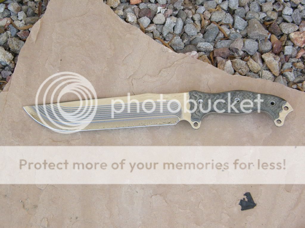

Flared fine I wasn't sure of the length so guessed at 15/16" I sanded the ends. Maybe they could have been a bit longer. In the pic there appears to be some lines but they are hardly noticable in person and could easily be polishing out I am thinking. No tearout. This is the best pic I could do sorry.

Well my friend you have way better fingers than I do then it was to much work trying to hold it all together by myself. I did think about them hitting and you are right about the thinner scales. Next time I will probably get some brass tubing and polish it. I will have it apart again so not getting to excited about it right yet.

Those look great Redrock and the pic shows them well. I would be very pleased if I had done it and they turned out that nice.
Great job. Thanks for sharing your process!!!

That vise was a stroke of luck for me. I was doing a job for a guy and noticed his vise laying in the corner. I commented that it was a nice vise. He said he had been lugging it around for 20 years and never used it. He said it was time someone else used it. So I brought it home and mounted it. It has come in handy many times. It flared those rivets no problem.
