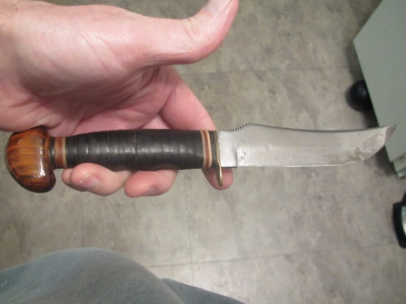

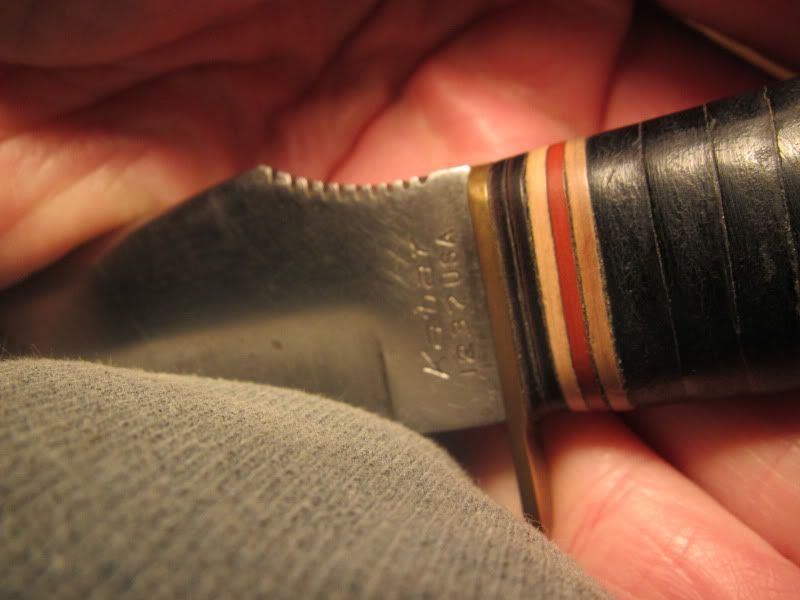

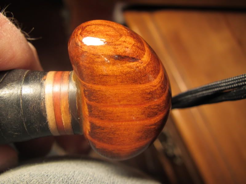

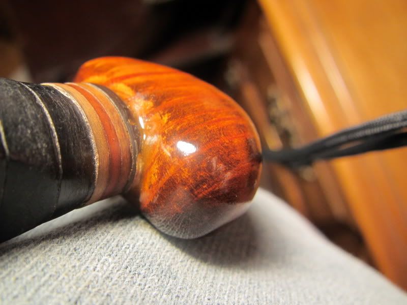

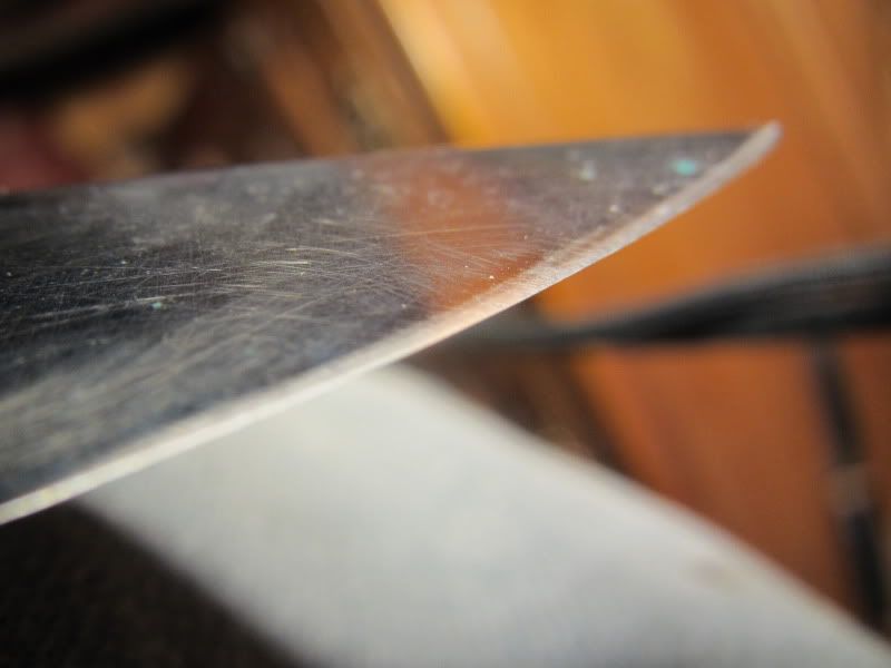

This was a knife that was knocking around in my Dad's tool box. Don't know any history but it was in really bad shape. Heavily rusted, pitted and missing the pommel. The tang where the pommel attached was almost completely rotten out with rust. I went to work on this knife about 13 years ago in my basement with only a vise, some files, hand saw and sandpaper to work with. I made a pommel out of some old wood. Back then I polyeurathaned everything

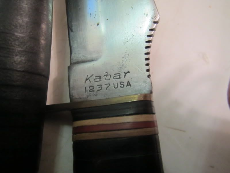

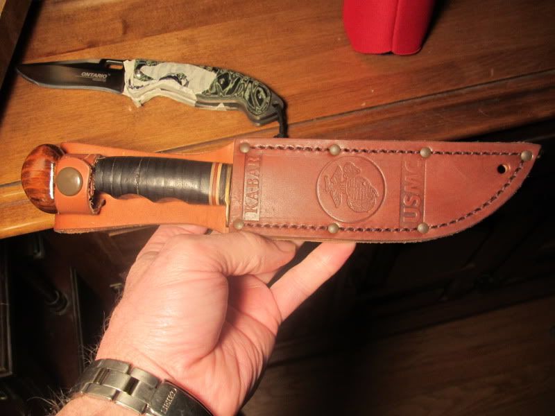

. I used a wood screw that I cut the head off and threaded the other end to screw into the tang (like a stud). I epoxied everything at the time of assembly. I finally found a sheath at the Stl knife show last January that finished the project off. It has a wickedly sharp convex edge. Figured it was about time to show it off. Anyone have a guess of when the knife may have been made? Hope you KA-BAR folks like it :thumbup:
