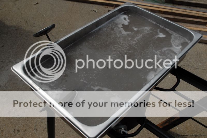

Basic DIY Parkerizing Formula
- 2 gallons of distilled water
- 2 “biscuits” of clean 0000 steel wool
- 1 cup of Klean Strip brand Phosphoric Prep & Etch (or other phosphoric acid etching solution around 35-45% concentrate per the Prep & Etch MSDS sheet)
- 6 rounded tablespoons of manganese dioxide (available at pottery supply stores or eBay, which is where I bought mine)
Do this outside - never in your house or shop (unless you have a great vent hood)
Add acid to water in a stainless pan/pot and heat to 190F - don't boil and waste it. I use a baking thermometer clipped to the side of the pan.
As the solution warms shred the steel wool into the liquid and add the manganese dioxide
Let the mix sit and dissolve the steel wool before adding parts
I always blast my parts before I parkerize them - I've heard guys tell about using a wire brush on a buffer or drill press as well but I've not tried that.
Make sure your parts are very, very clean - degreased and only handle with rubber gloves after
You can suspend your parts in the liqud with stainless wire. Leave them until the fizzing stops or about 30-40 minutes. The time varies.
Rinse the parts with boiling water thoroughly to remove the acid.
Spray parts with WD40 to get the water away from the steel
Wipe down with oil or apply whatever secondary finish you want
When you are done, let your mixture cool and strain the liquid through a coffee filter into a plastic can for future use.
The white precipitate is toxic. Allow it to air dry and dispose of following your area's hazardous waste guidelines.

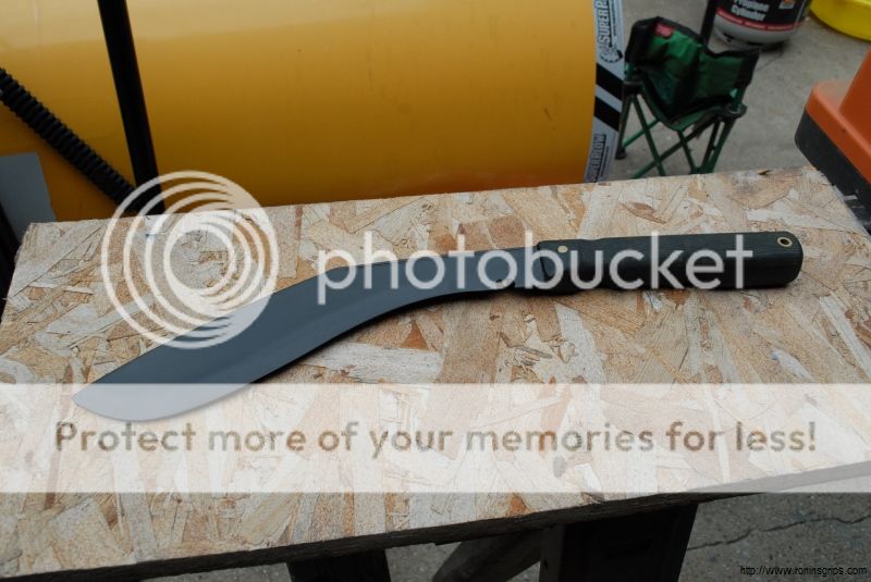

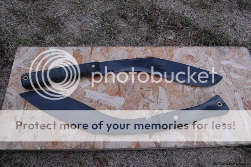

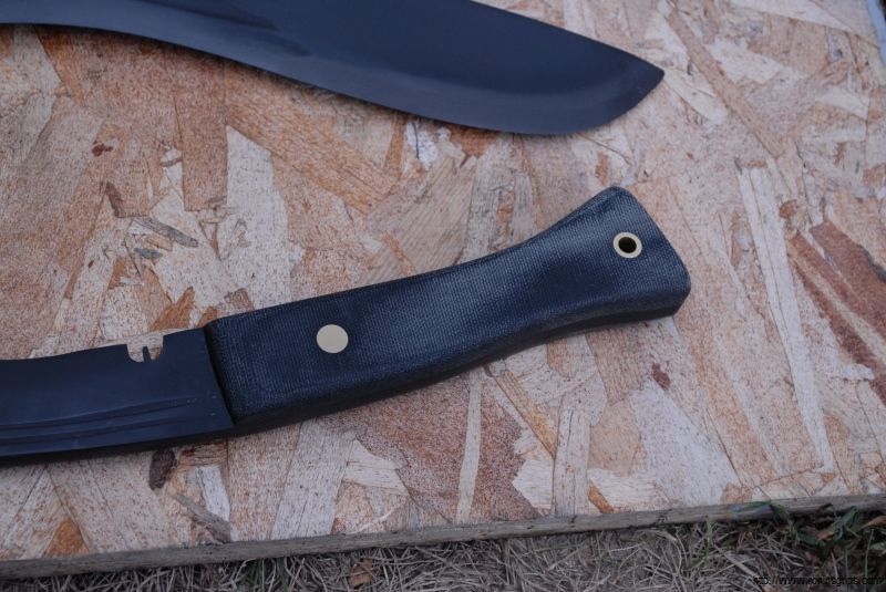

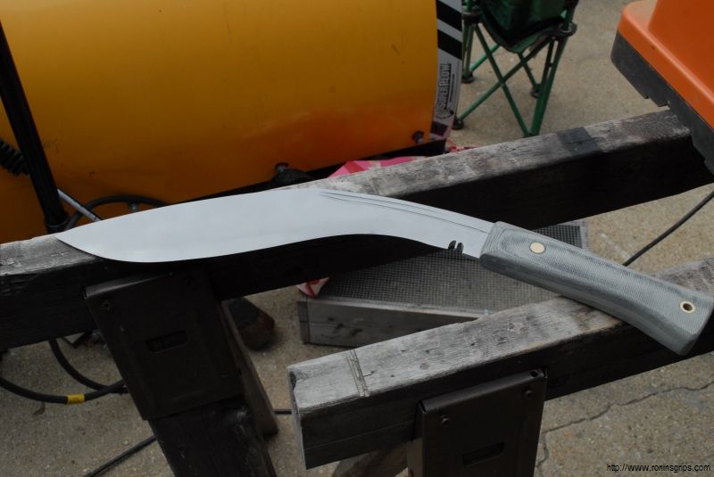

Before
During
After
Around 190F throughout Phil. Cooler takes longer and hotter isn't really needed plus you lose more liquid to evaporation.

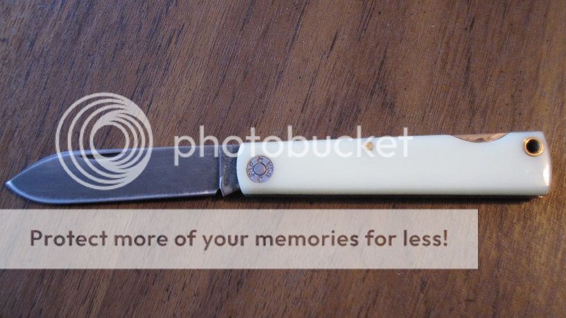

The hot/cold difference with the vinegar is pretty dramatic. I use it at room temp for the big khuks because it's easier to manage that way. I tried boiling it and swabbing on with a q-tip on this small O1 folder and it worked really quick and more evenly, but it was also more labor-intensive.
IMG_1710_zps9e878809.jpg~original
I did the room temperature thing with the apple cider thing too. Phillll left out the it works better when it's hot part.
That is a gorgeous knife Phillll, you know how some knives just sing to ya and others just don't? That Farmer Lock which I've never seen before is a gosh darn symphony. Well maybe bad analogy, I don't dig symphony much but Charlie Daniels or George Strait at their very very best. It totally rocks!
