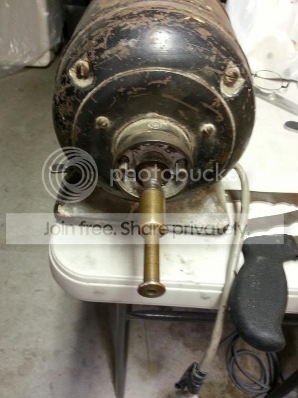

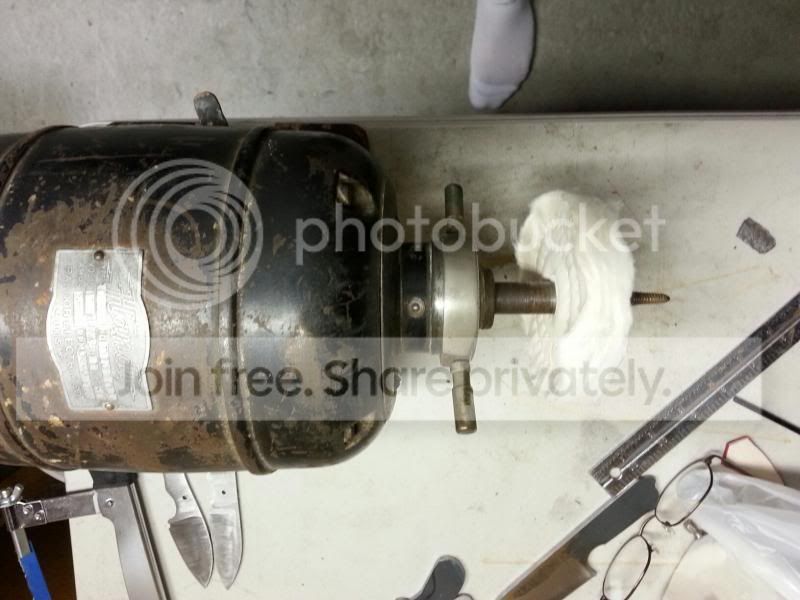

I just scored this old buffer and was wondering if it is missing stuff or broke, or both. lol the part with two handles sticking out turns around but doesn't tighten. and on the other side it has the brass part on the spindle. It still works thanks for any help
The part with two handles is likely used to press off stuck mandrels. It would have originally screwed in and out. It may be stripped. There would have been on on the other side too. it won't effect anything.

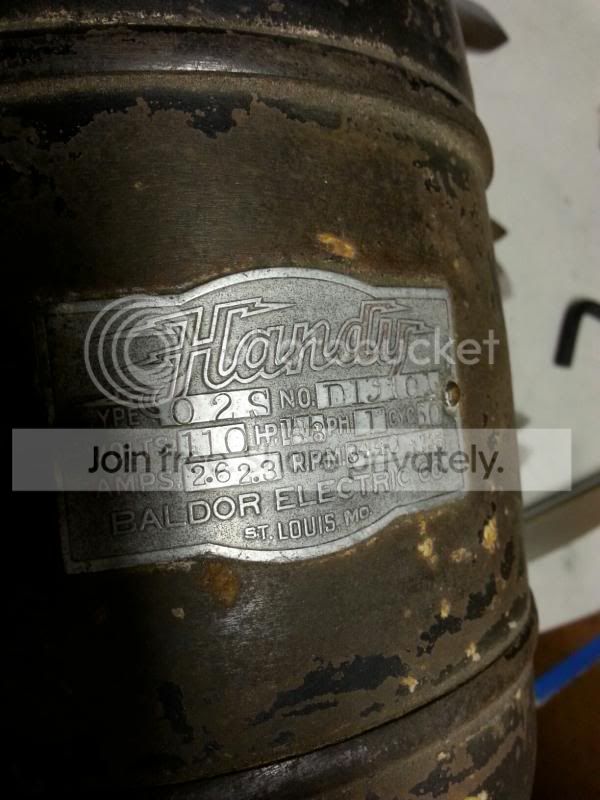

That is an old watchmaker's/jewelers bench motor/buffer.
The two handled piece is to press off the mandrels. There was one on the other side, which is missing. They were rarely used, and is on no need or concern for you. The odd looking piece on the other end runs the belt to the watchmakers lathe. It can be removed and another tapered spindle or buff mandrel put in its place. Make sure you put the proper "hand" spindle on (RH or LH).
Now, the bad news is that this is a very low power buffer made to polish very small things. It will not be totally useless for knife work, but is very limited. At 1/8HP it will only spin a 4" buff and will not polish steel blades and such. It will be OK for buffing wooden handles and small things like a brass guard.
Be cautious, as it is a high speed buffer...3440RPM. It will burn a wooden handle or toss a small object across the shop in a flash if you aren't careful.
