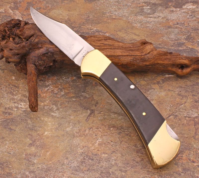

300,
nice micarta inv 2 liner-is it in as gooda shape on both sides? and is it a new pick up?
Fritz,
Think I showed a pic of it in the photo thread before, bolsters needed a polish, couple of tiny dings on front bolster edge but scales are good. Sharpened only a little, no sheath, no box. Spring find.
