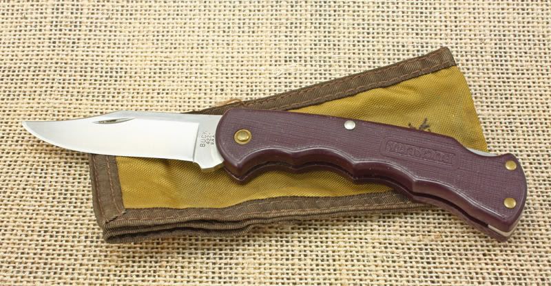

Think I showed a pic of it in the photo thread before, bolsters needed a polish, couple of tiny dings on front bolster edge but scales are good. Sharpened only a little, no sheath, no box. Spring find.
BUT, here is a early model Valox 422 with a dot, the other color from ItsTooEarlies. Somebody refresh my memory on the dot, you know someone is going to ask. I carried this one a little back when, no box but that is the original sheath..... 300
Since I am posting this from home, I don't have any info close by that gives the weight of the first generation (2 pc riveted handles) or second generations (1 pc handles) and I don't remember the weights. But, the material for both of those generations was a GE material called Valox, which is a Polyester based plastic. They had a failry heavy glass loading to increase strength (small glass fibers like fiberglass). The first and second generation Bucklites were essentially bullet proof. I do not recall ever receiving one back for a broken handle.
These Bucklites hold a special place for me as I was my Micarta 112 that we used as the basis for the original 422 Bucklite. The second generation was my project as a project manager/engineer. They are great knives...but I am a bit biased. I have the second knife off of the production line, with my name and the date engraved on it and signed by Chuck. It's one of those things that is priceless (to me at least) and I am proud of it.
I would never hesitate to use one of these for anything.
