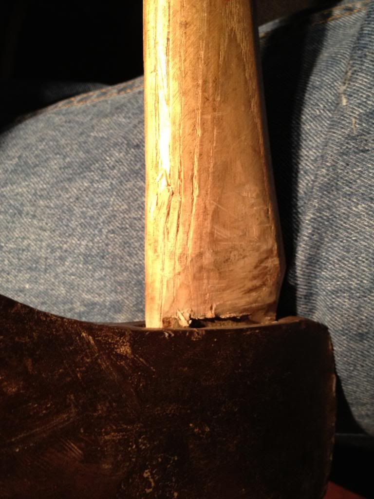

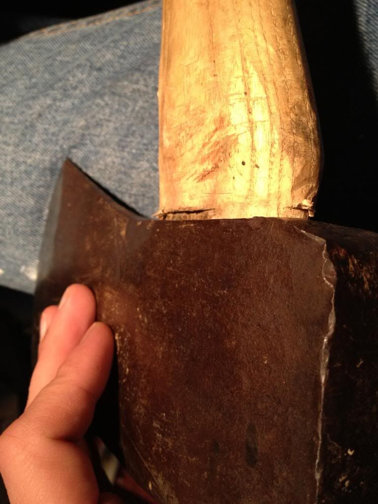

A few years ago, I found this axe in the woods, laying in the mud obviously long forgotten> I took it home, used it a little, or tried to use it. but it is in pretty rough shape - I do believe it may need to be re-hafted and the edge is all torn up, does anybody know someone who I could message about bringing this axe back to life?
You can see here that the head is slipping off, this is where it sits after i pushed it back on
Hard to tell, but the front of the haft is also all chewed up making it really uncomfortable to use
Top shot
Full view

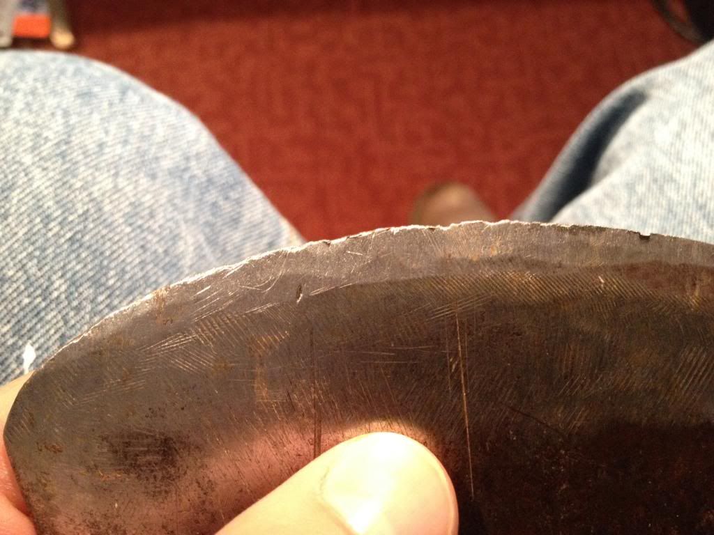

You can see here that the edge is really torn up

I'd toss the old haft and find/order a new one. Clean it up with a wire brush at least. A file will bring back that edge - it will be some work, but nothing that can't be done in a couple evenings.

I really like the pattern. Nice rounded face and plenty of weight in the poll. I would file the mushrooming off and tidy the face slowly but certainly would not remove the patina.

All you would need is a new haft and a file and she would clean up great. Hope it cleans up well looks like it should from the pics)
Nice axe! Might rehang on the same handle too. I never find anything worth a darn. Lucky!!:thumbup:
