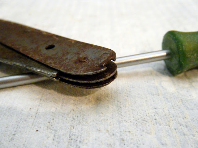

Where do I start? I am guessing the pins will have to be ground off the scales to start taking it apart.
The pins aren't real. Look on the tips of the bolsters-you will find folded tabs of metal. One end is open, the other is a slot. Carefully pry the open end up with a small flat screwdriver, just enough to clear the liner. Then, lift the scale up and push it toward the rear-sliding the other tab out of the slot.

I used a pin punch to start the front tab like Bill said and then went to a small screwdriver. I only bent it 90 degrees, just enough to clear the body.

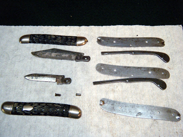

Here the scale is removed completely
This is the end opposite of the tab. You might call it the hook or back end.
Both scales removed looking at the back end.

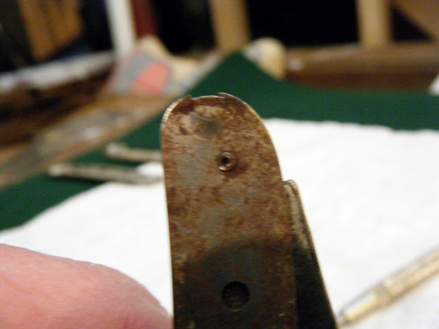

Here are the best photos of the rivets up close on one end. I think it is the blade pivot.

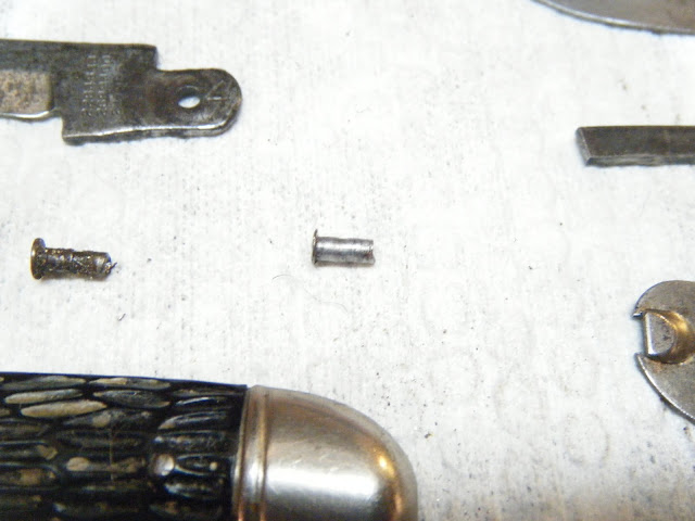

I have popped out all of the rivets and started the steel wool cleanup of all of the parts.

Where to I find the .0875 diameter rivets to reassembly everything??

You arent going to use pre-made rivets. You are going to make them! Locate some common nails that are slightly larger than you need, and chuck them in your drill. Use a file to turn them to the proper diameter. You might get lucky and find nails that are the right size.
When replacing the pins, use this order: pivot first, rear second. Then you will have to compress the backspring with a vise to insert the middle pin.
Then, you can use a small hammer, like a tack hammer (or smaller) to peen the rivet heads. Let me know when you're ready.

Do the rivets have to be from steel? What about brass rod? It looks to me like the originals might have been hollow.

Brass rod will work just fine.
