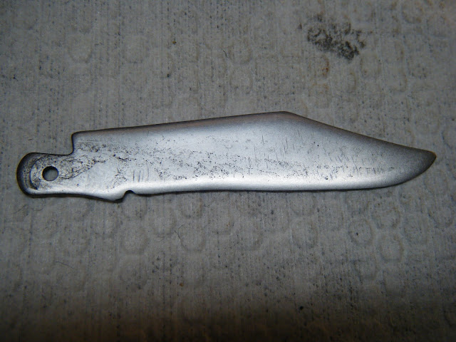

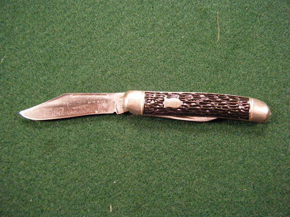

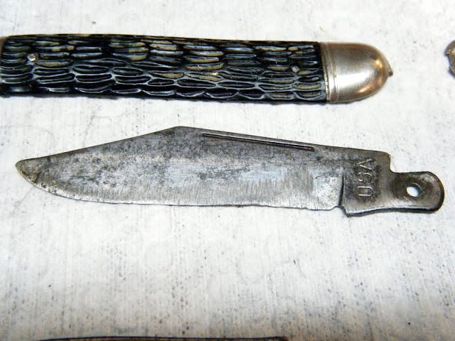

So here is the big blade in its original condition.

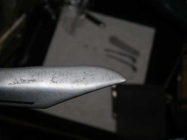

I only had 800 which didn't seem to touch the grind marks, and 240 grit wet/dry paper to start. Got some 400 grit today and after about 45 minutes, this is the result. How much further should I go?
I am thinking it is good enough. I am not trying to make it look new considering the condition of the rest of the knife. Now to work to bring back the edge? Should I flaten out or reshape the edge a bit before starting to sharpen it?

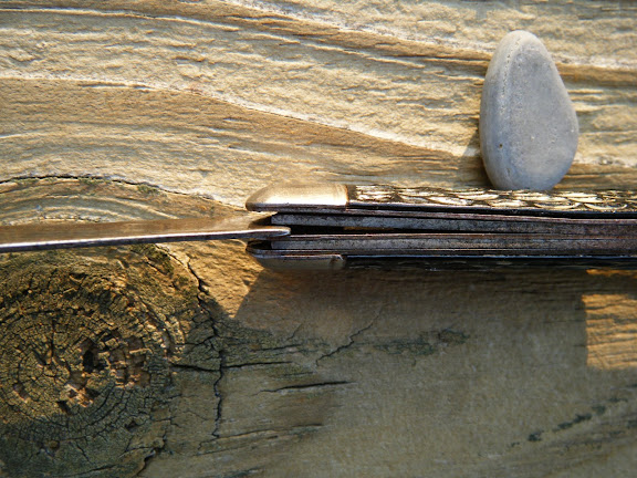

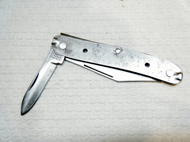

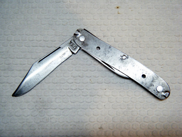

How critical is the fit on the pins/rivets? I found that a 4 penny steel box nail measured about .0825" after smoothing the burr off the shank at the head. The rivets I pulled measured about .086", the hole about .088. I'll post a photo after dinner tonight.
Also, should I put a light coat of oil on everything when I put it back together?? Worried that the rust removal with steel wool and sandpaper will cause future rust.

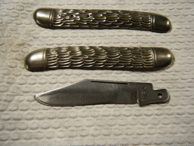

It was time to start working on the scales. I tried soap and water to start and then some mineral spirits and a toothbrush. Nothing seems to work. In the process I managed to flake off a large piece of the original black "plastic" covering off the scale. So it was done to polishing them with 00 steel wool and a fine brass bristle brush.
The scales are one piece stamped so I figure I can tape off the bolsters and “finish” the center section. I would like a similar black bone look. Is there a finish/paint out there that can be applied a bit thicker and may be baked on in the oven?

Was the scale covering wrapped around the scales?
I would use several coats of enamel, building the surface up. You can hit the tops of the "pins" with a file.
Yes Bill, the old material was wrapped around the scale. So, plain enamel paint will last for the occasional pocket carry? I was thinking about Gun Kote or something like it, a baked on finish.
Gun Kote would hold up better. It will take several coats to match the original thickness. The original scale covers are celluloid, heat-fitted over the scales.
The rivet fit is pretty critical. You can chuck a larger nail in a drill, and file it to size.

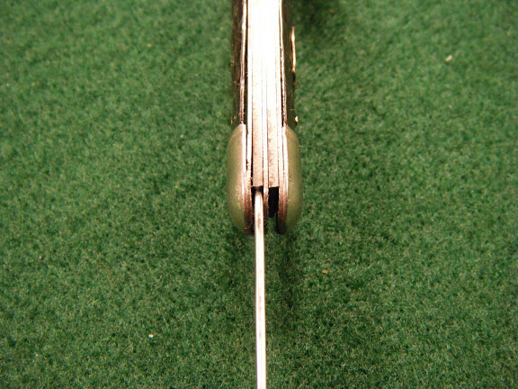

After spending some time on the blade edges with the Lansky sharpener, I decided to give the reassembly a try tonight. The pivot might have ended up a bit on the tight size but not so bad that I will take it apart again.
Be very careful when you install the scales. The tabs won't take much bending, before they break.

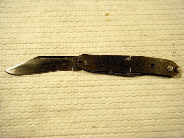

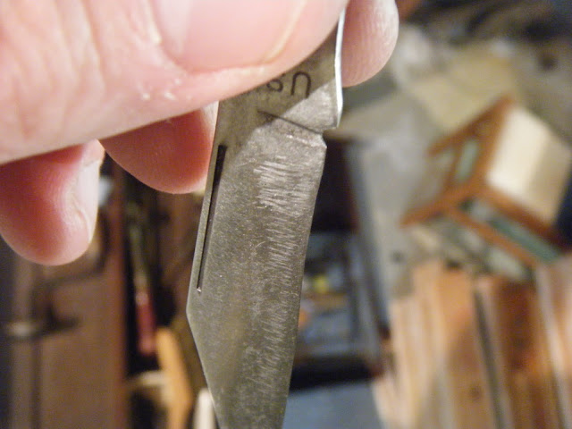

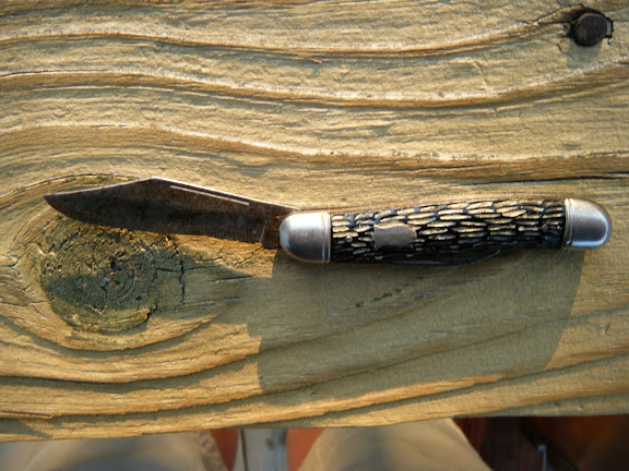

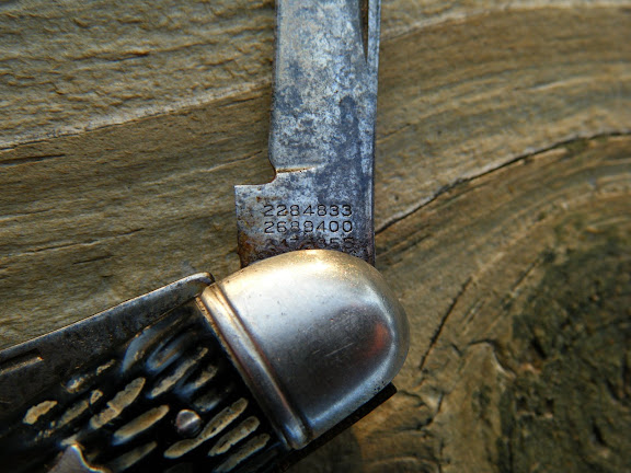

This old two blade folder was in a collections of tools I got from my Grandfather. It's in such bad shape I am thinking about taking it completely apart to rehab and repair it back to some usable form, learning about folders at the same time.
Where do I start? I am guessing the pins will have to be ground off the scales to start taking it apart.

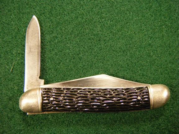

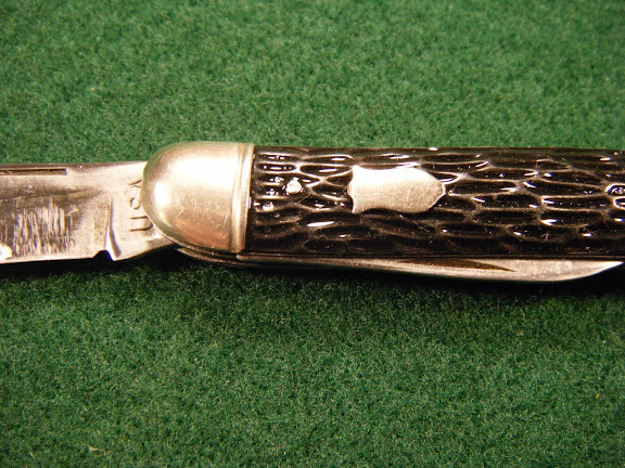

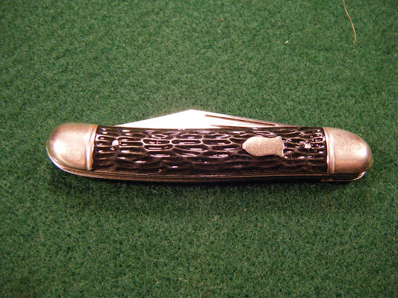

So here is the completed project. Can't say it's perfect. I am not completely over the moon with how the scales turned out using the Testors modeling enamel. But the knife is back to a usable condition. Bill, I can't thank you enough for all of the pointers.
