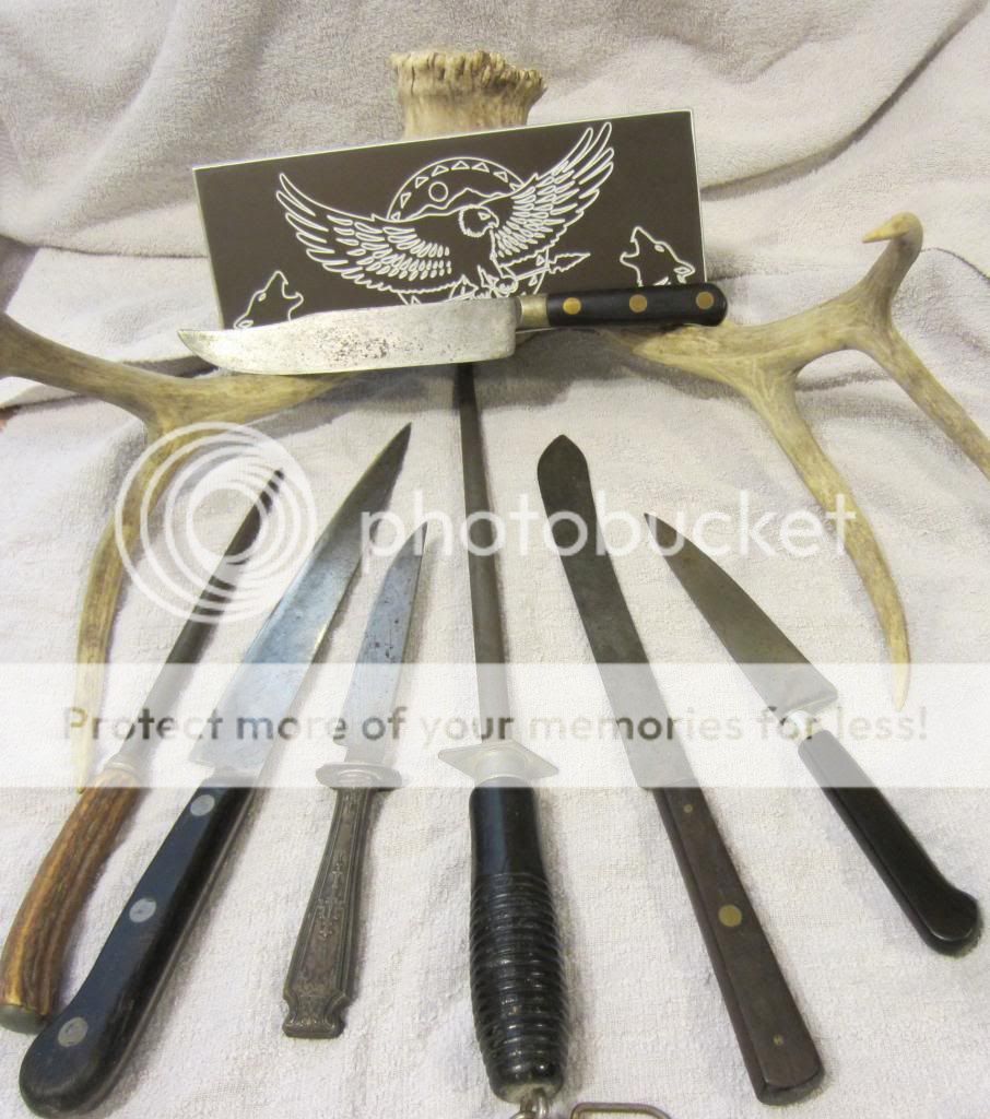

Old Hi Carbon kitchen Knives
Those old knives are great and will last decades. Many are still going strong.
Here's an old ForgeCraft
The Green River steel in the center was $1 at a yard sale. :)
The small chef's knife on the right sees a lot of use. It's a little light sabre, no one else will use it. :D
