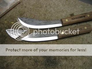

Old Hickory knives are great steel!!!! 1095 carbon steel. One of the best IMHO.
I've modded a few skinners. They come in at 0.090" thick and are great for that nessmuk mod.
The butchers knives are ~0.050" thick. Still 1095, and good performers.
I did a bunch of mods of em.

Hey guys, I want to do the Nessmuk mod on the skinner becsuse of this thread, is there any stores that carry them instead of ordering them?
Not as far as I know. Be sure to get the skinner.
Thanks Fiddleback, going to take your word since your the master of making Nessmuks!:thumbup:
Andy you do awesome work! i have gotten a few OH's to try and mod and play with . They can take a wicked edge, and slice like crazy.
I've appreciated the quality, economy, and simplicity of Old Hickory kitchen knives for many years, but I think the grind on most models is better suited to slicing than to chopping, unless you are chopping something pretty soft like banana trees or smaller vines. Long ago I bent the edge of a very similar knife when I tried to chop down a slender oak sapling. Recently I bought a good Old Hickory 7" (?) boning knife for a buck-fifty I think it was in a thrift shop I was prowling around in.
Well, I'm a master of nothing much really. With a little elbow grease and patience you can easily match my OH mods.:thumbup:
Fiddleback:
How did you get the slight recurve in the handle done? Did you take out a bit underneath, then cut the wood to have a palm swell?
