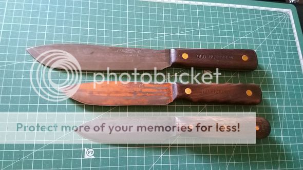

Anyway, this picture is of three 7" old hickory knives i altered. Top one just altered blade shape and sanded handle. Middle one i added a copper patination, and the bottom one i changed the scales to burnt oak with copper pins.

How do you add a copper patina? I’ve never seen that before.
I put a couple or three 1" x3/8" bars of pure copper into a litre of fresh ferric chloride. Leave it in there forever. After a few days stir up the solution and then dip your blade into it. Experiment with times, re-dipping etc as every time it comes out different. When you take out of the solution gently clean blade then give a very gentle polish to give the copper a shine. Must be a high carbon blade though......stainless will just laugh at you :-)
