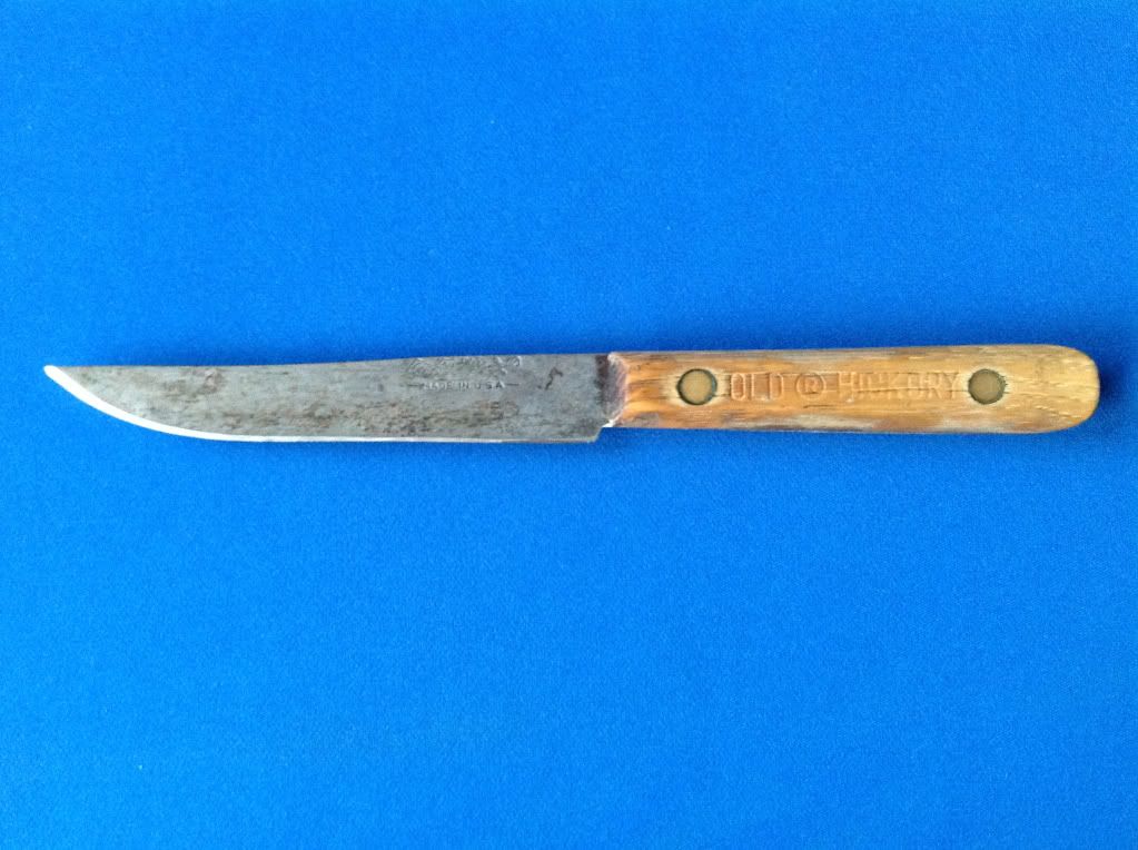

Heres an update for the old hick I'm working on, Silver soldered the guard on and finished shaping the tang...just gotta drill the antler and pin the blade (set in epoxy). This guy will have a raw hide sheath that should be durable outdoors.

what is the spine thickness on these? I bet it is fast in the hand!
Heres another shot for ya...pins just mocked in place, will epoxy it next week.
Thanks a lot guys! More pics will come when its epoxied and then the fun wood core raw hide sheath. The blade thickness is 0.095" which is just perfect for the needs of this knife.
